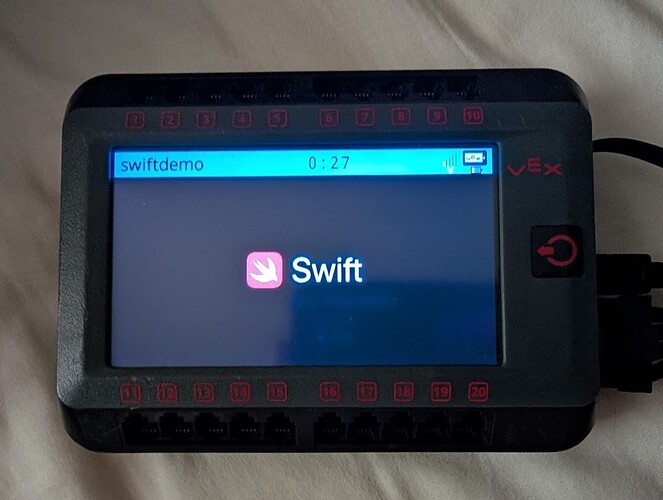

Last year at WWDC24, Apple announced official support for compiling code written in their Swift programming language for embedded devices (low-power systems without an operating system). This caught my attention, since I mostly regarded Swift as a very high-level language mostly used for writing iOS and Mac apps. I wondered if it was possible to get this kind of toolchain running on some weird devices, but the docs were severely lacking at the time and everything was very under-developed.

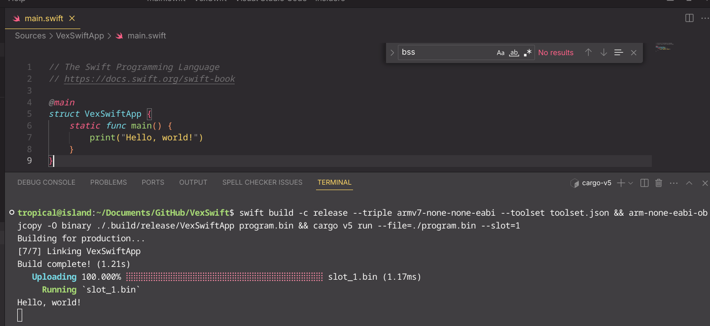

Last month, embedded Swift was brought up in a discussion again, and @lewis and I were interested in seeing if we could compile and run a Swift program natively on a VEX Brain for fun. At the time, Apple had just recently published documentation for compiling to ELF on embedded ARM using a custom linkerscript (which is what we were looking for), so Lewis started working on a proof of concept toolchain for all of this.
After setting up some basic plumbing in a C support library, we now have the first VEX program written in Swift!
How?
(incomprehensible technical jargon ahead)
As it turns out, Swift is a pretty standard compiled language that shares much more in common under the hood with C, C++, and Rust compared to a language like Java or Python. The key thing here is that Swift uses LLVM as its compiler backend and is able to link with C libraries and call C functions from directly within its language. Because of this, we’re able to compile Swift code to native ARM instructions that the Brain can immediately recognize and run.
Why?!
This was done for fun and pretty much no other reason other than “eh, we could”. Neither @lewis or I plan to seriously use this in competition, though after messing with it, Swift does seem like a pretty cool language to write with.
Source code?
Due to some potentially sensitive implementation details, I won’t be linking to any source code on this forum. I mostly just wanted to show this off because it’s a fun proof of concept and I find it neat that we’re able to run so many higher-level languages on this system.
