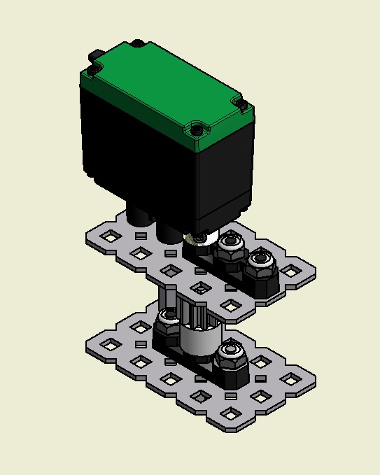

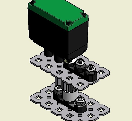

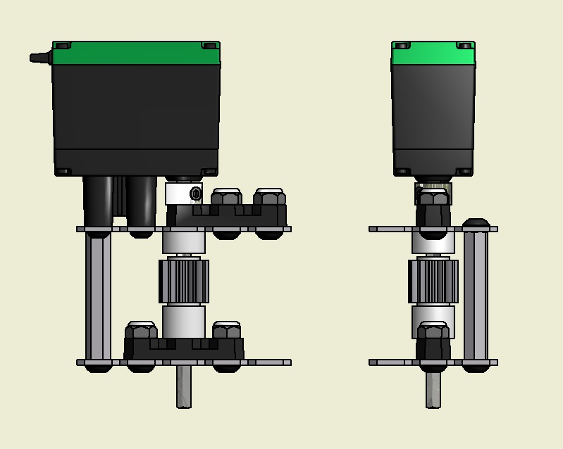

I think every team creates their own internal standards, we try and do the following.
  1. Always use two bearing flats to support an axle.
  2. Always use lock nuts to secure the bearing flats, no plastic rivets.
  3. Try and always have the screw heads on the outside of the robot, aesthetically better and helps with robot size.
  4. Trim all axles to length, however, we try and avoid cutting the standard length axles (2", 3" and 4") and make custom axles from the 12" lengths. We don’t trim axles until the design is finished if possible in case the design changes. We also try and arrange that axles will be cut to the nearest 1/2 inch where we can.
  5. If at all possible allow access to the motor screws so as to be able to tighten them
Here is an example of what is typically done (it’s not a real part but shows the concept, axle not trimmed here).
[ATTACH]7126[/ATTACH]
[ATTACH]7127[/ATTACH]
A hundred times this. I can’t tell you how many mechanisms we built without thinking about accessibility and maintenance. Sure we would make the motor fit really nicely somewhere, but it was a huge pain to have to tighten the motor screws when the motor became loose (and they always become loose at some point).
What Jpearman is showing is in my opinion a great example of motor attachment. You have the bearing supporting the shaft and a shaft collar inbetween the bearing and the motor housing, ensuring the shaft won’t come out. Plus the motor screws are accessible for an added bonus. Beautiful.

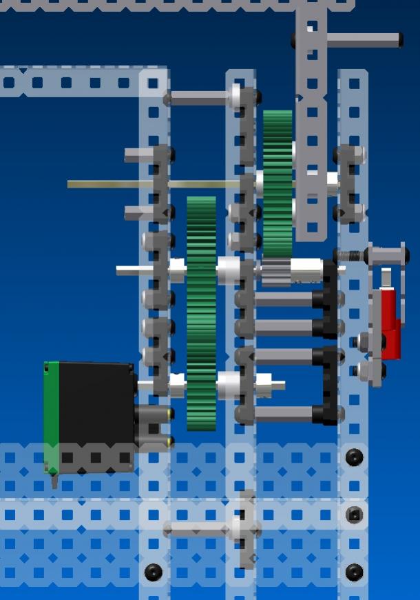

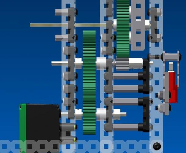

We’re getting a little off topic but I wanted to show another example. I had posted this photo a few weeks back.
https://vexforum.com/attachment.php?attachmentid=6987
Here is the CAD for this (slightly more recent, the design was improved), I have made some of the structure transparent so you can see where the bearing flats are mounted.
[ATTACH]7128[/ATTACH]
The axle under the most stress is the one with the final 12 tooth gear that drives the 60 tooth to which the arm is attached. It has three support points with the third being in between the two gears. This design did not use any structure above or behind the arm as I wanted the arm to be able to rotate more than 180 degrees to the rear of the robot.
Something else I try and do is make the spacing between the C channels in this type of arrangement allow standard structure to be attached. This generally means not using, for example, standoffs directly but adding extra washers and spacers so that the 1/2 inch hole pattern aligns correctly. You can see part of a 5x25 plate and 1x2x1 C channel that connect all the tower supports together. The arm is also not directly attached to the 60 tooth gear but uses spacers to allow both left and right arms to be again connected using standard structure with holes on the 1/2 inch pitch.
