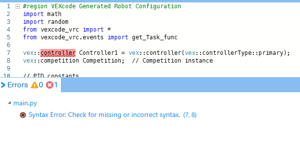

So I have made a pid code that runs pid in c++ but there is a syntax error and it wont let me run. I have been to worlds before and I am going again and last time out autons didnt work and I have a pid code and i need help could some one help me fix it please!!! Here is the pid code.

the syntax error is between lines 3 and 4.
Thanks you
post the error you are seeing, it compiled ok for me.
it says a project run time has occurred. Please check error panel for more details
you can’t use C++ code in a Python project.
OH thank you so much i did not realise that.
