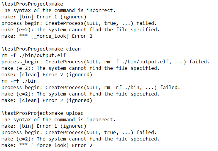

I am exited about the new features of PROS, and I love the idea of building and uploading to the cortex from the windows CLI. Cody’s recent video on building and flashing the PROS kernel, with a program, onto a cortex is great, but the documentation for PROS at
http://purduesigbots.github.io/purdueros/index.htm#CmdLine
made it seem to me like there is a (windows) command line building feature that is completely included with the new PROS IDE.
That documentation that I linked above says that one should be able to use “make” and “make upload” to build and put code onto the cortex, and I assumed it referred using these commands in the directories of the generated PROS projects from the latest PROS IDE. I even see there is a Makefile in generated project folders. However, after installing that IDE, running these commands in a project folder generates errors.
I would appreciate direction in getting PROS projects onto the cortex with the command line. Is Cody’s method the most straightforward? I am a total beginner to this.
attached are screenshots of the make error messages - I copied/pasted them into notepad so I could hide my dirnames :slight_smile:
Hi @CannonT,
It’s great to see enthusiasm for the new PROS CLI. The CLI will be cross platform and available for the major operating systems. The new PROS IDE will be launched here in a few weeks (can sign up for the beta here: https://edjubuh.typeform.com/to/qyamAc)
Can you confirm which operating system you’re using?
@edjubuh,
Thanks for info! I am running windows 10 home x64.
Did I mistakenly use the old IDE software thinking it had the new features?
To be clear, I didn’t touch on the PROS CLI, I used regular old Unix make and James’s stm32flashCortex utility.
