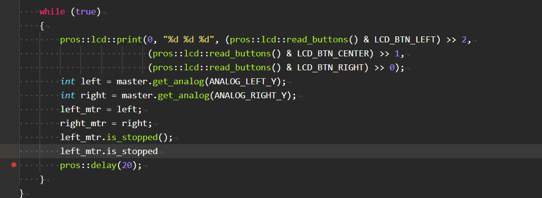

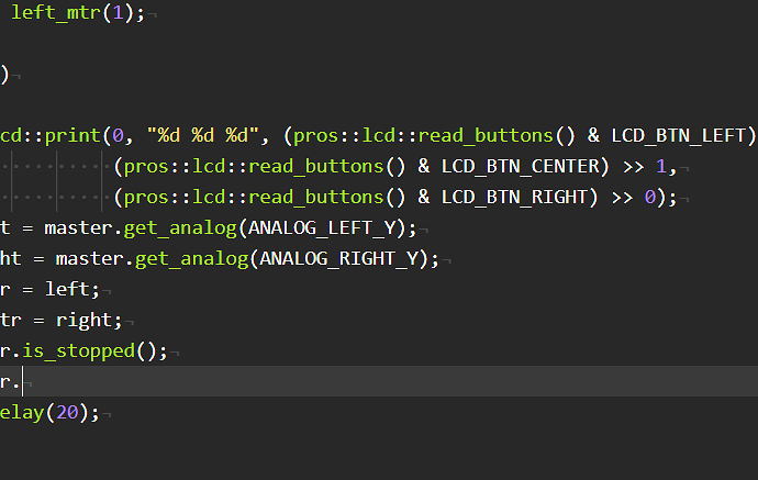

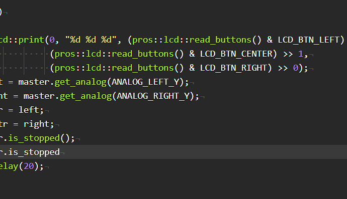

how to use Language Server ? i can’t use autocomplete…
and i can’t even ctrl+click or cmd+click to jump to definitions.
I only installed CLI.
The language server is powered by cquery, and is only installed when you install PROS Editor. If you’re using your own editor, you need to get cquery on your own (or just install PROS Editor to get cquery) along with a plugin for your editor capable of interfacing with cquery.
