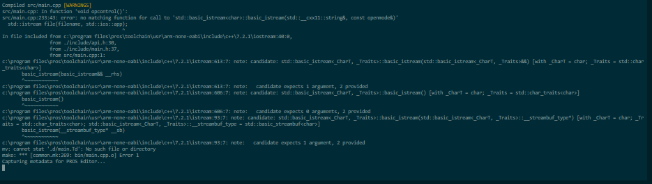

I tried this but I am getting
You should learn more c++.
The compiler just told you everything that is wrong.
The example provided above had a small typo, but they linked you to the documentation where you could try to figure it out yourself. The typo was that istream was actually supposed to be ifstream. The documentation also showed that ifstream belongs to the <fstream> header, which you need to include into your project
#include <fstream>
Next, you have a error where it says “read was not declared in this scope”. This means that you did not create a variable name read, which you need to be able to write to it.
Finally, you have this error:
printf("Left: "%s, read);
Hopefully the syntax highlighting makes the error obvious: %s needs to be inside the string (inside the quotes), not outside.
Hopefully that solves your problem, and don’t be afraid to analyze the compile error, read docs, or do your own research on google.
I already had included and the error is still
Did you read my reply?
Thanks, it now compiles!
