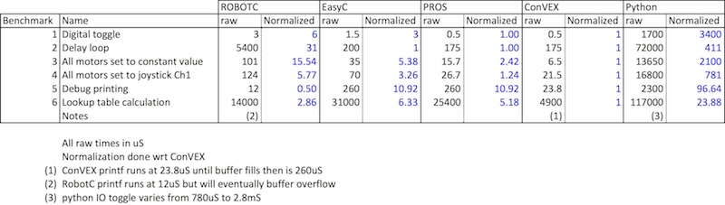

I’ve also been looking at robotmesh, also free. It runs Python which is a giant plus for me since it’s generally a much easier language to learn, while still being heavily used in… pretty much anything. The web based IDE has autocomplete functions, is responsive, and it seems that the API is simple enough. I’m going to be evaluating both today (read: writing basic drive and PID code to see how much I like it.) but would like to hear from others: Have your teams used this? Have you had any major issues with it?
The current version (I should say the one I evaluated in December) was IMHO unusable, very slow, has memory management problems. They are working on improving speed, but I have not heard if it has been improved enough for typical competition use.
[ATTACH]9325[/ATTACH]
Wow! Those numbers! Okie dokie then. PROS or RobotC it is. Thanks!
do you think it would be a good idea to try to port a LLVM python compiler to the cortex? it would definitely be faster
The developer is aware of the performance issues and has plans to address them.
