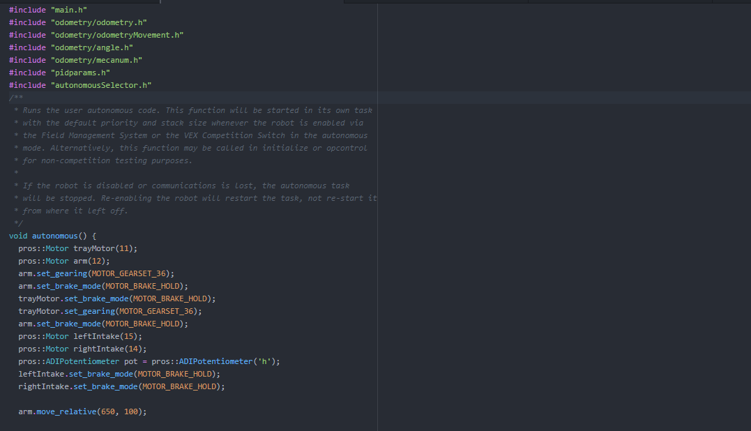

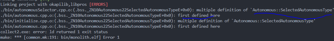

So I am trying to build a project and I keep getting the error :
Even though It is not being defined anywhere but there. By removing
#include “autonomousSelector.h” it builds and works. The problem is I need that file in my autonomous.
Heres the code: Autonomous:

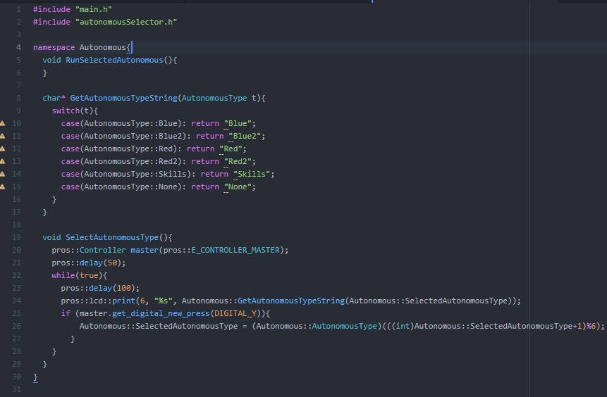

autonomousSelector.cpp:

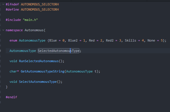

autonomousSelector.h:

Though i’m not a CPP expert…
in the hpp, I think you want to change AutonomousType SelectedAutonomousType;
to extern AutonomousType SelectedAutonomousType;
and then have the cpp define it in side the namespace like:
namespace Autonomous {
