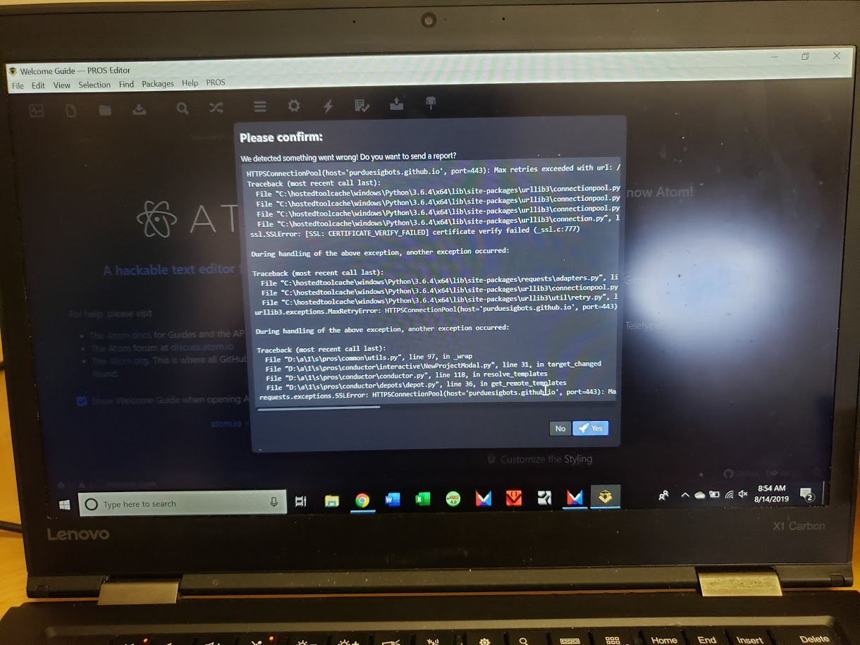

@Eden @nickmertin well my initial problem isn’t occuring anymore but I have a new one. If I try to create a new project, this error shows up and I’m not sure what to do.20190814_085439
We tend to see that when the network you’re on has github blocked for whatever reason
lol I’m using my school’s internet and that makes so much sense now, thanks mate
Contact your teacher to discuss with the higher ups to have it whitelisted. Github is only for coding purposes and it shouldnt have a reason to be blocked.
