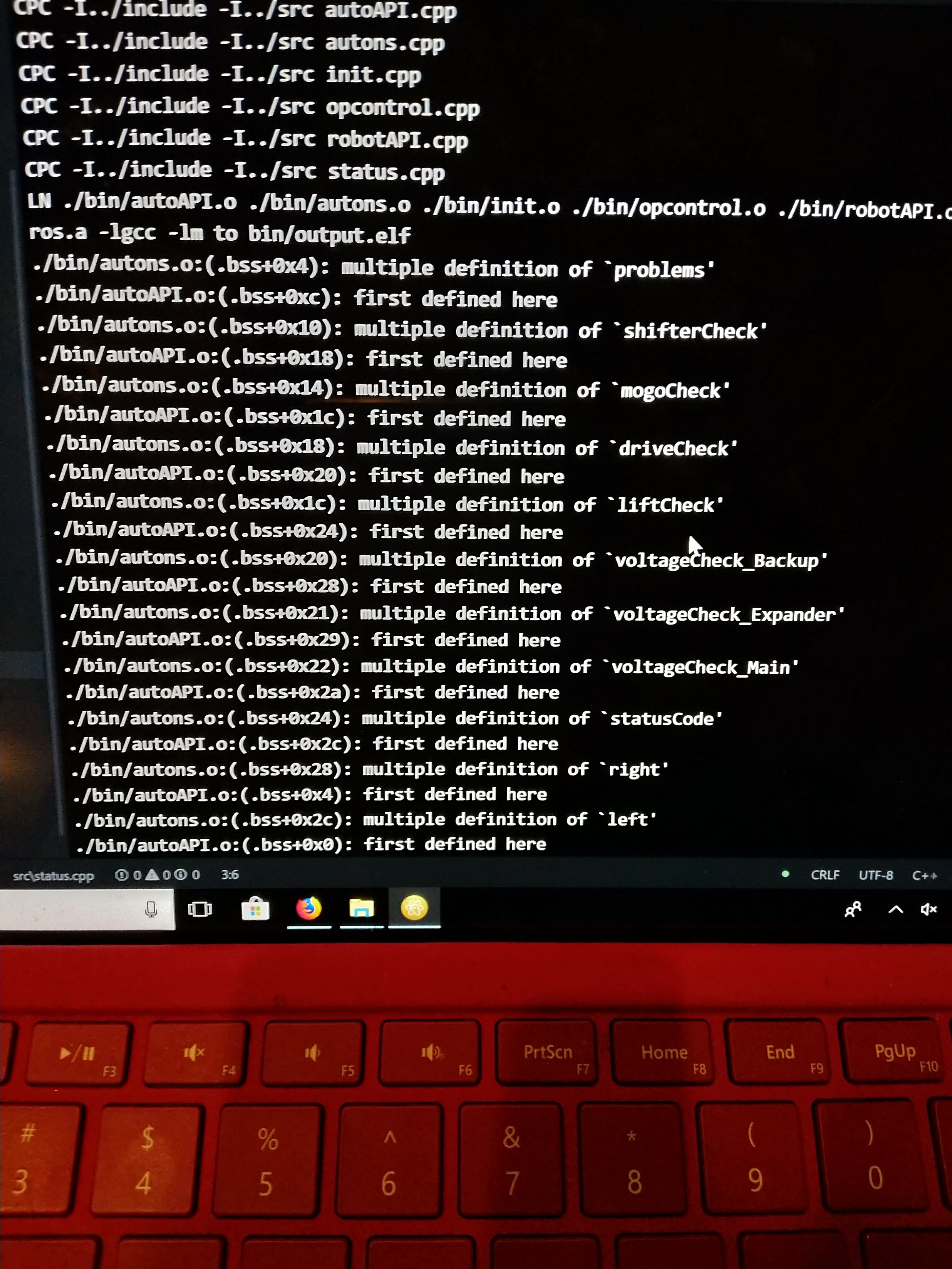

I was trying to see if it were possible to use C++ in my pros project instead of C so that I use classes to organize the mess of variables and functions that is my code. Through pros doesn’t seem to reject the classes or the .cpp files, I come across a multiple definition error from the linker. This even happens if the .cpp specific content is removed; if the src files are .cpp I get the errors, but not when they are .c files it works fine. I have proper header guards. The only things that get multiple definitions are objects for encoders and the gyro, though any other objects that I add also have the same issues. If anyone has any ideas how to fix it that would be greatly appreciated.

Can you post the errors.
Scratch what I said about it only being objects. All global variables spur errors. It goes on like that for a while. However it is fine with .c files with identical code.
It seems to imply you have the same function in more than one source file. For example, “shifterCheck”, where is that function defined ? autons.c or autoAPI.c ?

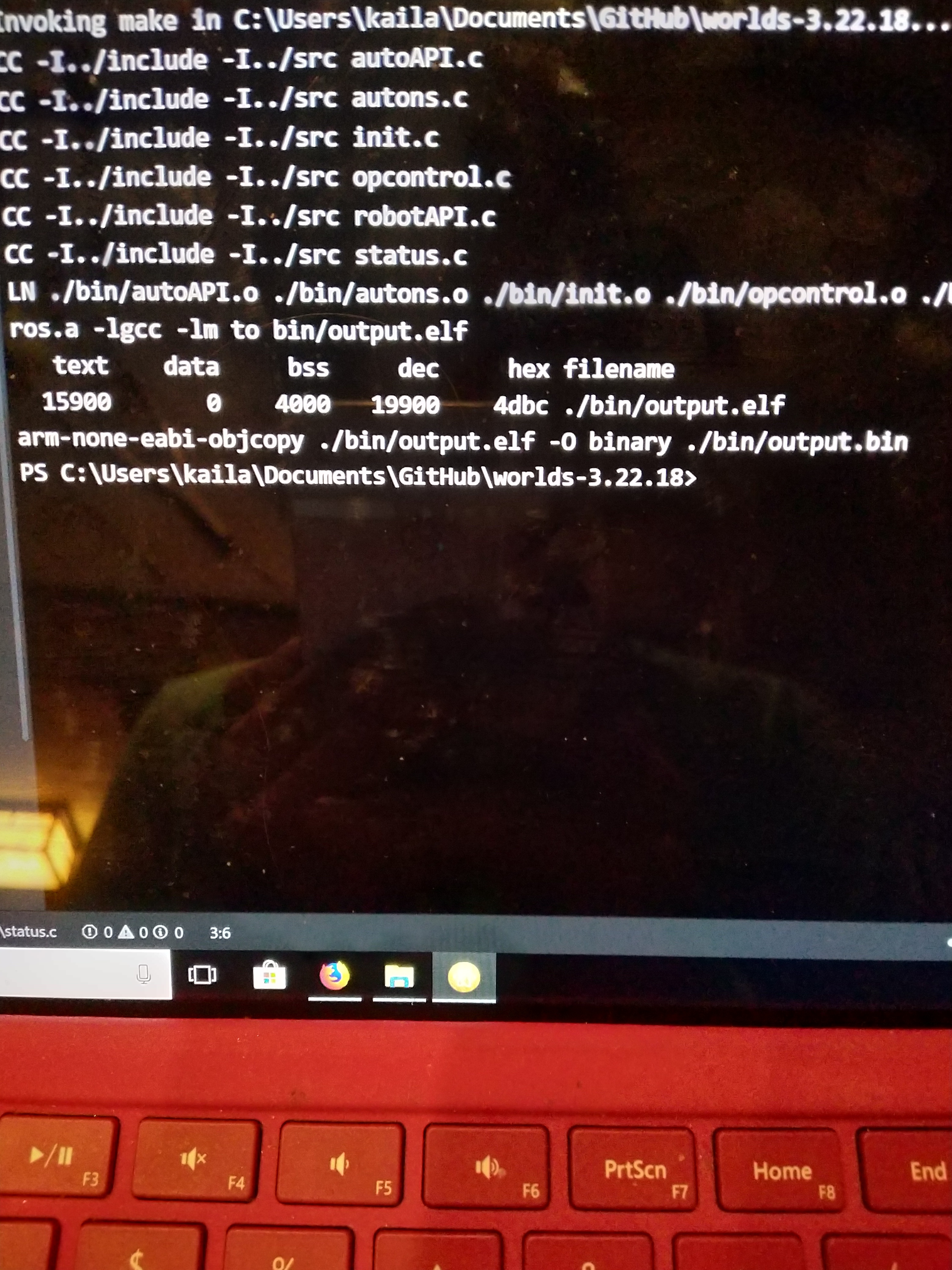

“shifterCheck” is a Boolean to track whether the 4-bar motors and sensors are properly working. None of the errors are from functions, only variables and objects. One of the pics shows the files compile fine with .c extensions. But it gets confused with the .cpp extensions, which are necessary for using classes. Also it seems to be an issue with the main.h because it shows errors for every global variable in each file which includes main.h.

Ok, couple of problems.
you define all your functions as extern “C”, but they are not if they are in C++ files.
you include this in every source.
#ifndef _STATUS_H_
#define _STATUS_H_
int statusCode;
bool voltageCheck_Main, voltageCheck_Expander, voltageCheck_Backup; // battery charged y/n
// status of each mechanism: 0 is working, 1 is encoder issue, 2 is motor issue.
int liftCheck, driveCheck, mogoCheck, shifterCheck;
char problems[10];
void systemCheck();
#endif // _STATUS_H_
So you have multiple definitions of all of those variables. The include guards only stop you including that file more than once in a single source, not across several source files.
A global variable should only be declared once in a program
int statusCode;
everywhere else you want to use that declare it as extern.
extern int statusCode;
