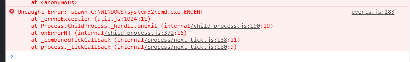

Hello,
Sorry to open another topic on this but recently I have made the switch to PROS from VexCode. Whenever I try to use the quick action button to make and upload the project it throws this error. This error has also happened to two other people in our robotics club who have recently installed pros.
'C:\WINDOWS\system32\cmd.exe' could not be spawned. Is it installed and on your path? If so please open an issue on the package spawning the process.
I have tried to look around but so far only dead ends. Based on other fixes I have confirmed that cmd is in my path, reinstalling pros does nothing and my project name has no spaces in it.
Screenshot 2020-10-15 121844 Screenshot 2020-10-15 121830
My current workaround is just to navigate to the path of the project via command prompt and use the pros CLI to make and upload, but it would be appreciated if I could get any help on how to fix this for convenience.
Thank you,
Unfortunately, as of right now, there is no solution to this problem, the workaround is to use the CLI.
