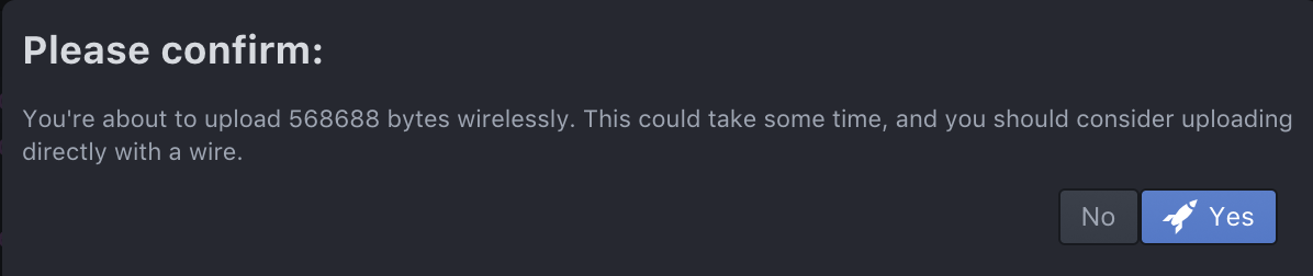

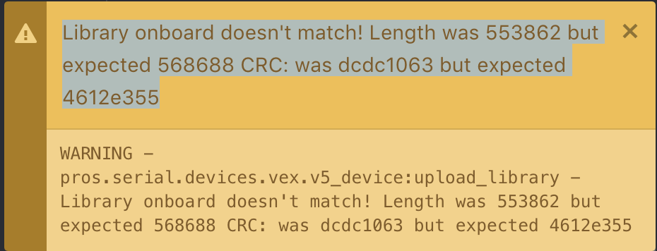

I have a program that seems to build without any errors but uploading causes errors about file size and wireless upload or wired uploads. I am also using an adapter from type c to usb to micro which goes into the V5 controller. The following errors come up:

Those aren’t errors, its just saying that it needs to upload the whole program because the cold binary changed. Upload over a cable to the brain as the message says or just download wirelessly and wait a few minutes.
