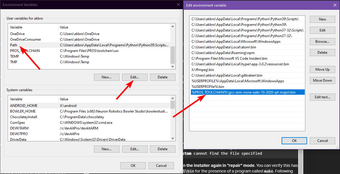

UPDATE: if you are unable to build projects, please add %PROS_TOOLCHAIN%\gcc-arm-none-eabi-10-2020-q4-major\bin to your PATH environment variable as a temporary workaround (guide). Your PATH should look something like this when you’re done:
You will then have to restart any instance of the PROS Editor or command prompt in order for the change to take effect.

To fix either of these errors, run the installer again in “repair” mode. You can verify this has worked by checking the path %PROS_TOOLCHAIN%\bin for the presence of a program called make. Following this, you will likely run into problems that can be resolved by applying the workaround from my first update above.
