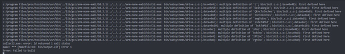

Having errors compiling my code using PROS cortex. It’s been a while since I used c so it may be that.
These are some of the errors I have been receiving:
I checked opcontrol.c, drive.c, and init.c and saw no problems. It may be a problem with main.h

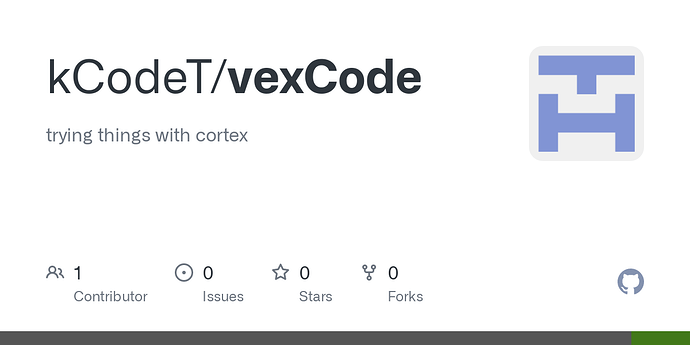

Here is the github link to my code:

Ok, the problem you’re running into is that you’re setting the values of those variables in drive.h, so by including that file both in drive.c and in main.h (which is subsequently included in init.c) you now have multiple definitions of the variables. Consider setting the values for the variables in drive.c

To build on @thermonuke ‘s point, you can also move the definition into the source and only declare it in the header file
//in myFile.hpp
extern int x; // declaration
//in myFile.cpp
int x = 5; // definition and re-declaration
