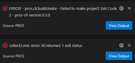

Hello, I was normally coding in PROS, but when reopened my project a week later, all of the namespace reference (e.g pros::Motor) were showing as errors: name followed by ‘::’ must be a class or namespace name.
Why has this happened? I also created a new project and it did the same thing… without any changing to the default project.
Another note:
When I try to build the project, it shows this error: ERROR - pros.cli.build:make - Failed to make project: Exit Code 2 - pros-cli version:3.5.0
I have tried cleaning the project, to no effect.
Any help would be appreciated as we have UK nationals in a week.

Issue 2 (build error):
Issue 1 (pros namespace not working), this persists throughout):

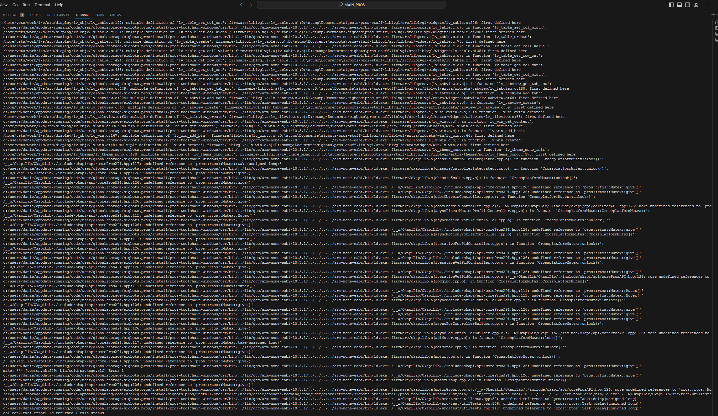

Can you send a picture of the PROS output tab when you try to build the program? Also do you have the Microsoft c/c++ extension installed in Vscode?
Please run pros make all in the PROS integrated terminal and send the full error message. It seems like you have linker issues.

This is the error when build it
Creating cold package with LemLib,libc,liblvgl,libm,libpros,okapilib [ERRORS]
followed by a mess of directories
followed by:
PROS-CLI Version: 3.5.0
PROS-Kernel Version: 3.8.0

When I make all I get this output:
followed by:

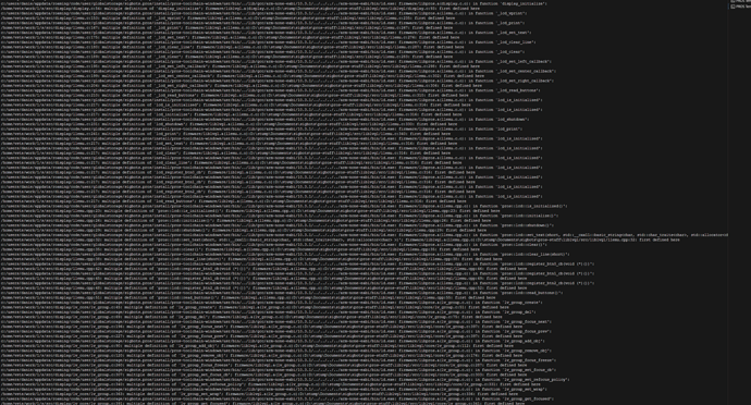

Can you copy and paste the entire error, including the mess of directories please?
unfortunately, i cant as it over triples the character limit
Attach a screenshot of them then. Those “mess of directories” are the errors in your code. Without seeing them we cannot help you.
What’s in your include directory?
