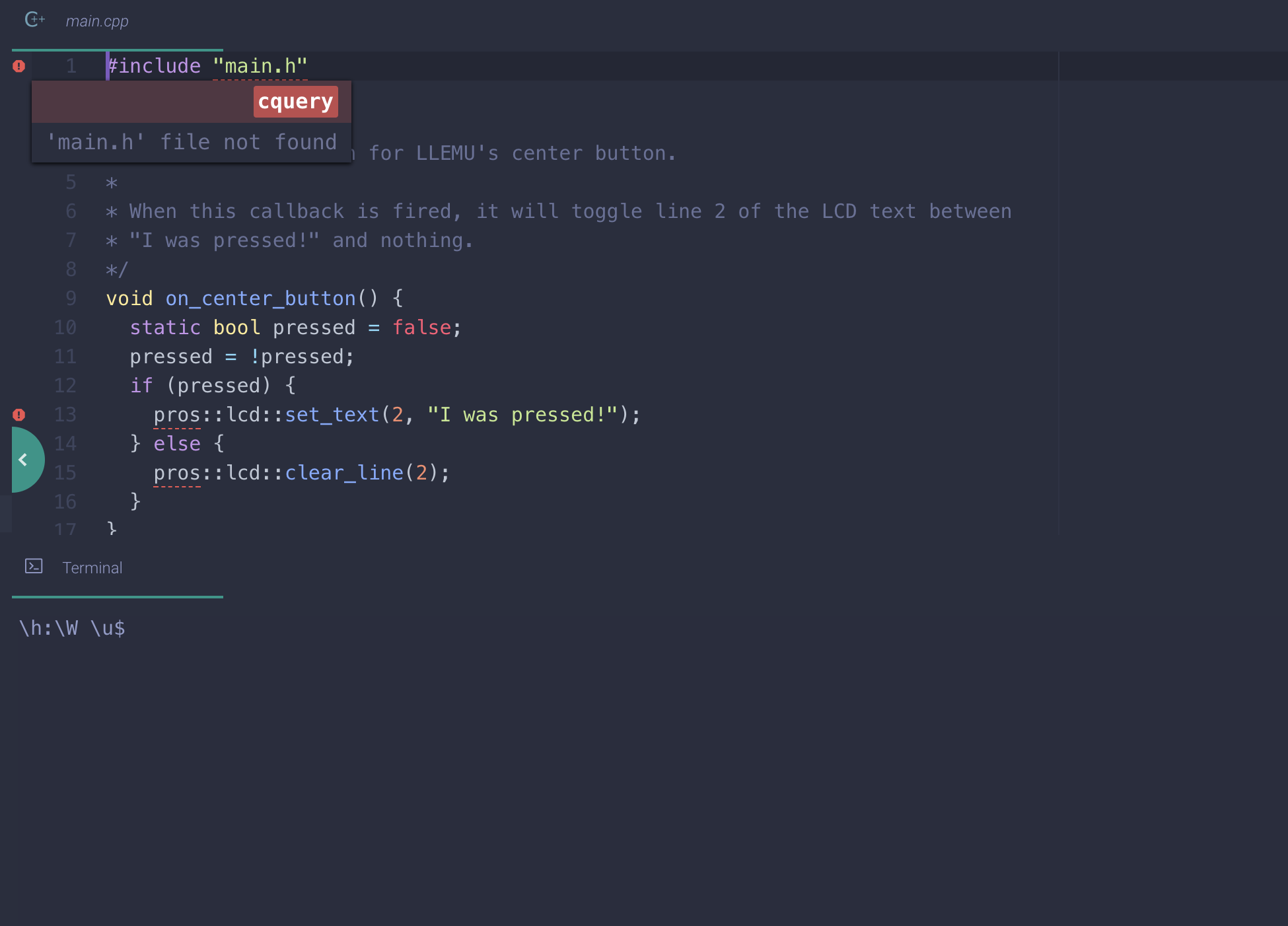

Greetings to everyone! I’m looking for some help since my Pros Editor doesn’t want to work. Every time I open a file I get some weird cquery errors05 AM
@andrew.gonzalez4
This is a pretty common issue, but it is easy to fix. This thread should help you find the solution: "main.h" Not Found (Linter). Specifically look at this reply.
Hi there @_Colossus! Thanks for the reply. I also have an issue where it says that the PROS CLI is not installed or not in the path. How can I fix this?
How did you install? Did you install the cli?
I installed it with brew and then with PIP.
Uninstall the pros-bootstrapper and pros-atom packages from the editor
