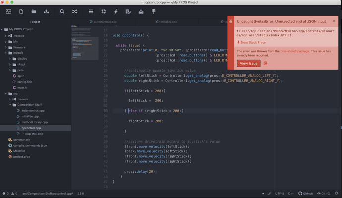

When I downloaded the program on the v5 brain, nothing happens, as in, no motors move. And I get a JSON error but it doesn’t indicate what’s causing that.16%20AM
We’ve gotten a couple reports from various folks using macOS. We haven’t been able to reproduce the issue and are looking for someone to help us do some troubleshooting on our Slack or on GitHub. If you could join and help us do some diagnosis so we can fix the issue, that would be appreciated.
I’m on my phone right now - I will share the Slack invitation/GH issues when I get home if someone doesn’t beat me to it.
Here it is =)
https://github.com/purduesigbots/pros-cli/issues
and
https://pros-development.slack.com
Do you need an invitation?

Yeah I’d be willing to, what I am supposed to do to assist?
This is the issue tracking what you’re experiencing - it has some instructions there.
