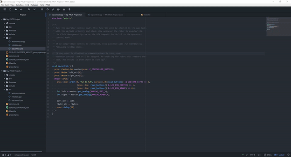

Interactive UI
We’ve reworked all of our UI dialogs so that the “business logic” exists in the CLI. This makes it easier for us to modify our dialog boxes and make them more responsive. Sentry reports can now also be sent through PROS Editor.
Screen Capture
Thanks to @69922Nathan for implementing screen capture of the V5. You can now take screen captures of your V5 with the prosv5 v5 capture command. We’ll be implementing a dialog box for PROS Editor with the next CLI release.

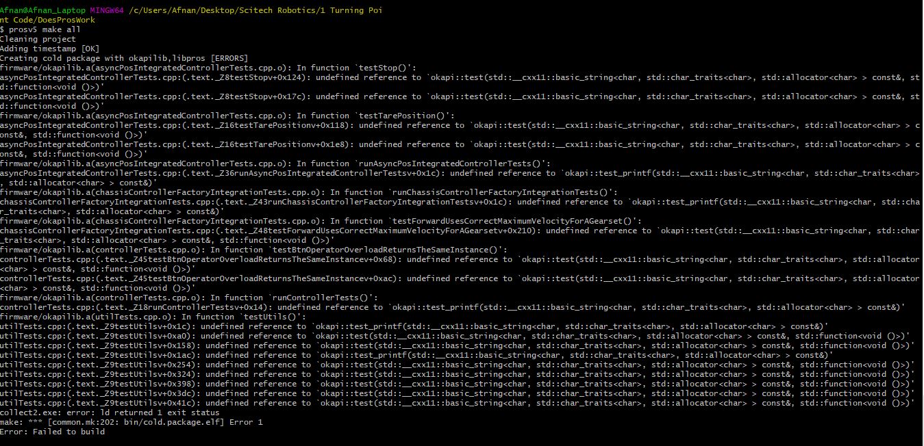

#17
So on my mac this time, It picks up the controller, but when I try to start a download, it immediately loses connection and the download fails.
Also does the same on my Windows machine:
I have an image from the terminal where I tried this (Windows)
Screenshot

#18
Image doesn’t work for me.
#19
fixed the image link

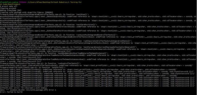

#20
Hey,
I was trying to build my project with the new update and when i set USE_PACKAGE to 0 it compiled just fine but when I set it equal to 1 it did not build and gave me an error with the Okapi libraries. I have attached an image of the command line below. When I set the USE_PACKAGE to 1 it works just fine however. Is it because some of my code uses stuff from the display library?
pros%20error
