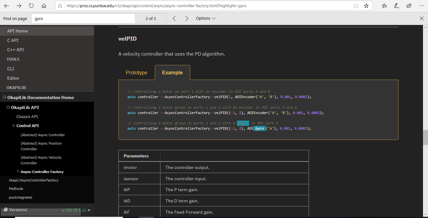

OkapiLib does not support using the gyro with the chassis controller.
I found this, but I may be misunderstanding it.
Yes, that is for an AsyncController, which is different from a ChassisController (it controls individual motors or motor groups, not chassis).
