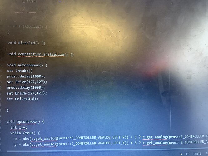

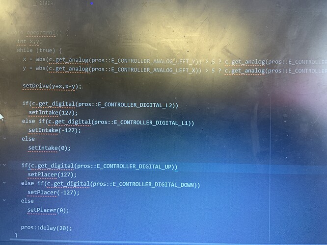

Pros help new autonomous wont save to brain and says spelling mistakes
image image
It looks like your linter might be broken. Does it compile (build) on your computer?
Also, there might be syntax errors although it’s not getting highlighted (linter issue probably) where you say set Intake(); as there is a space between set and Intake(). Here is a link to the same issue I faced : Issues with vexcode and pros
