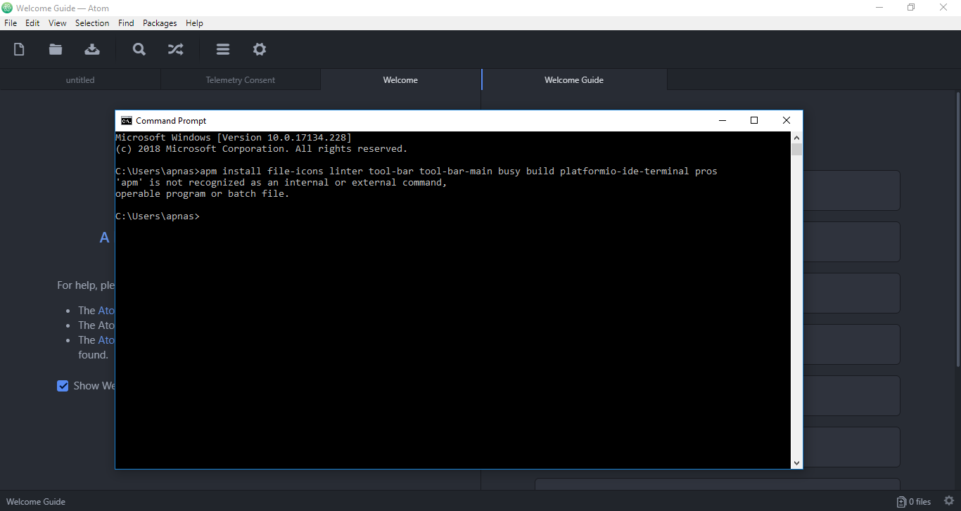

and press ‘Enter’. This should bring up a command window. Now copy the command from earlier and right-click in the command window and then click ‘Paste’. Ctrl+V will not work.
Take a screenshot of the output in the command window and post it here.

Here it is: without the installation of atom
You have Atom installed. The PROS Editor is Atom.
Follow the instructions here to manually add Atom to
PATH
. Then try the command again.
i did it still doesn’t work
edit: PLEASE HELP
Atom is still not on your
PATH
. Find the location of the Atom executable and carefully follow the instructions here.
is this what is supposed to happen
Yes. Once that is done, open Atom and you should be good to go.
