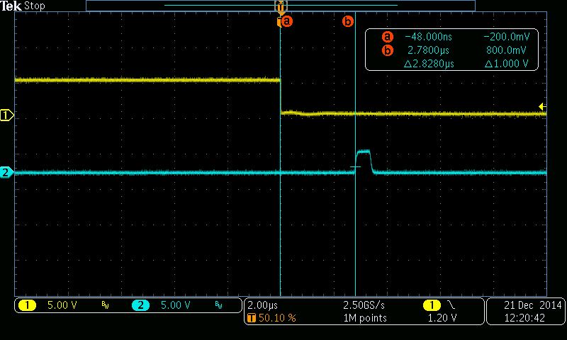

I would like to try making my own VEX sonar driver. Since it takes roughly 30 usec for sound to travel 1 cm, I’m curious how significant the interrupt latency would be as a source of error.

Don’t forget you need to measure the time to and from the object so an object 1cm from the sonar has 2cm of travel for the ping. I use 58uS/cm.
The interrupt latency is a variable but I would expect it’s less than 2uS. I didn’t worry about it too much and assumed 1mm theoretical accuracy was enough for all practical purposes (ie. 6uS).
Edit:

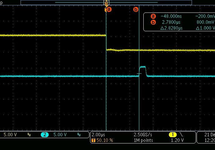

So I measured the sonar interrupt latency in ConVEX, from falling edge of the received echo to the interrupt is about 3uS with less than 1uS worst case jitter. Here is scope capture showing echo (yellow trace) to a pin set high then low in the interrupt code (blue trace). Obviously harder to do with PROS as you do not have access to the interrupt function. I time to uS accuracy, an interrupt is caused when the ping is sent (rising edge of the yellow trace) so the 3uS offset is effectively added to both start and end of the timing, ie. the only error left is the 1uS jitter, so the error in measurement will be 1/58 cm or 0.17mm. There’s probably going to be more noise, that is variation in echoes, than this.
[ATTACH]8837[/ATTACH]
Here’s the modified ConVEX irq callback, I was toggling digital out 2.
