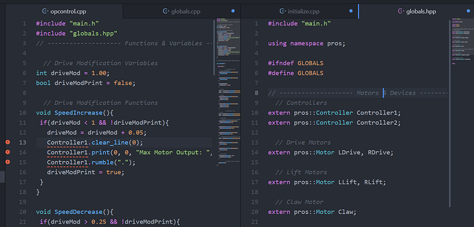

While coding opcontrol, I defined all my motors and sensors just before opcontrol function. When I went to the autonomous file to code auton, I realized that I can’t code the motors in and I must redefine them all. For autonomous and opcontrol, is there a way to define all motors and sensors “globally” or must I redefine them in each folder?
there is no way. the sensors and motors are just like regular variables and cant be automatically declared in all the cpp files.

So I took your advice and created the new files, but it’s telling me the motors and such don’t exist? and I don’t know what I did wrong. Could you or someone reading this who knows the problem help?snipocode
can u copy and paste the error? can you also send out globals.cpp

Your problem is probably that you have not saved the changes made to your files.
The blue dots mean that your changes have not been saved yet.
Hit CTRL-S on each file. You could also install a package that saves all files at once when you press CTRL-S.
At first it didn’t work but after restarting PROS after saving each file, my problems were gone, thx!
It was probably because the linter was out of sync.
