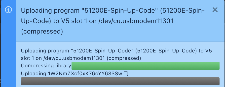

Hi, I am new to PROS and just started testing uploading code to the brain. When I build the project and upload it, the message(in image below) pops up but nothing transfers to the brain. Does anyone know why this may be happening? Appreciate any help!
How did you install pros? The toolchain or VSCode extension?
It looks like they used Atom. And that installed one o the PROS “packages” there. I would recommend installing VSCode by Microsoft instead of Atom and one the interface will be better and you can use the newer VSCode PROS extension. Even if that doesn’t work. Still download VSCode and then install the tool chain and CLI using the PROS website. If you give me your OS I can link the specific website.

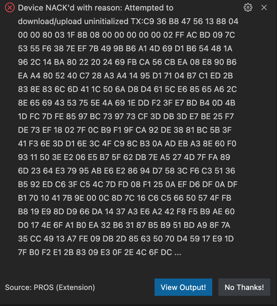

Now I have VS Code downloaded with PROS extension but when I upload it says:
Make sure that VEXos and the PROS CLI are up to date. If you click “Integrated Terminal” in the PROS Sidebar in VSCode and run the command pros --version, it should tell you your version. The current version of the PROS CLI is 3.3.3.

I tried that but it says im up to date. However, when I run pros --version it says it is 3.3.2. I also tried updating it through home brew but that said I am 3.3.3. Am I missing something?
Although that isn’t all the way up to date, it is still recent enough to where it wouldn’t be the issue causing the NACK you encountered. The only other recommendations I know to give you are making sure that VEXos is up to date (version 1.1.1 iirc), and to try uploading with other cables. Sorry for the inconvenience.
