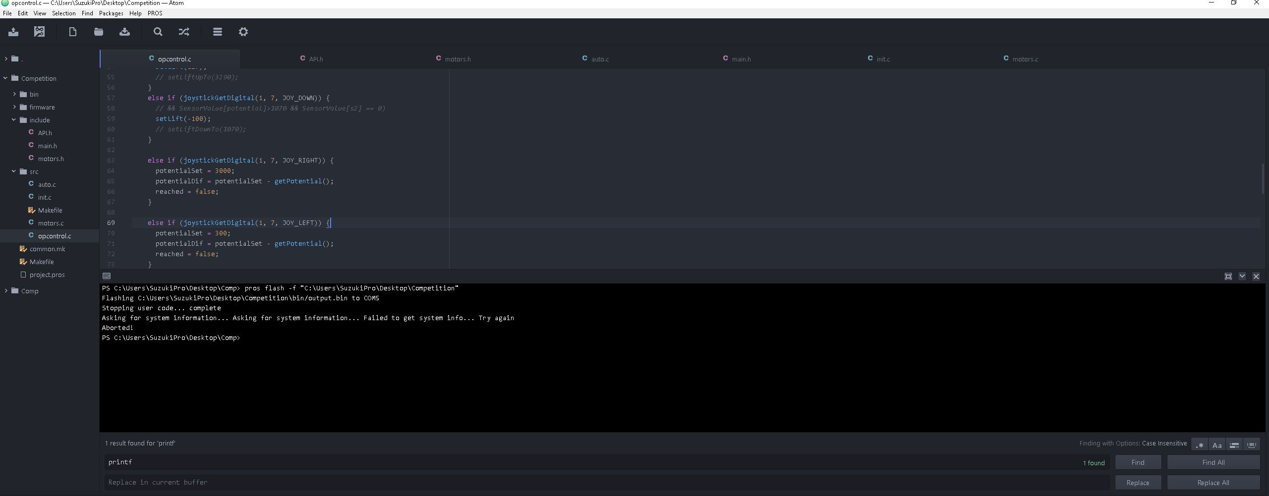

Ok, I’m not the owner of the thread but I’ll tell him to do it. Also, now when I try to download new code to the robot it says asking for system information and fails. Would this be because it keeps uploading the potentiometer value to the computer and isn’t responding to getting the system information?
That’s actually a pretty common thing that happens; most of the time there isn’t actually anything wrong. Just hit the Download button again; sometimes you’ll have to repeat this process a few times to successfully download.
