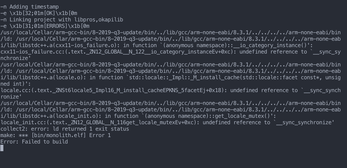

Hi, so I just downloaded PROS and this is all the code I have and it won’t build. Any suggestions?

That looks like a linker error. Sometimes this can happen if you have issues with your compiler.
You could try running the command make all in a terminal in your project directory. If that doesn’t work, you could try reinstalling the PROS toolchain.
Downgrade GCC to 8.2.1 or lower. How you do this depends on your OS.

Are you on a Mac ? looks like you have the same issue as was asked about in this topic.
This is the same issue, thanks for catching that. @ everyone else in this thread:

As to the error itself, the problem does not come from user code (or it would have shown the problem), but instead from the internals of GCC.
update on this issue: 🚨 Make things work with GCC 8.3 by HotelCalifornia · Pull Request #155 · purduesigbots/pros · GitHub
