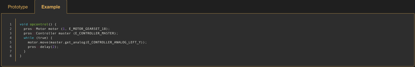

So when setting the gearing in my globals file for motors, an error comes up claiming that the " E_MOTOR_GEARSET_18" was not defined at this scope while this is what it says to use in the documentation. Any advice would be appreciated.

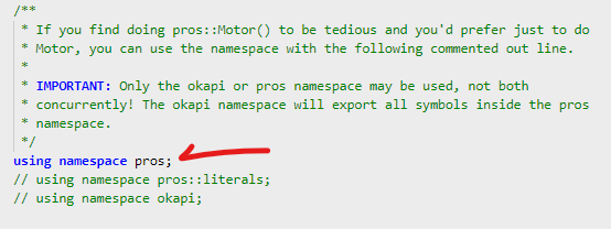

Or you could remove the comment here in main.himage
This allows you to not write pros:: in front of everything.
*or use namespace PROS
