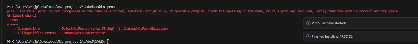

WHenever I click the pros intergrted terminal on VS Code and I try typing a command in, it says that the term pros is not recognized. ccan omone hep me
In your screenshot it shows that pros cli just finished installing. I don’t think you waited for it to install before testing because putting it in path is one of if not the last things installers like that would do
