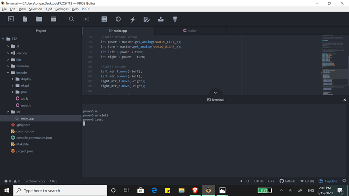

Our team uses PROS for programming, and in the past, we’ve always used the terminal and typed in “prosv5 mu” to upload our code. However, recently the terminal doesn’t respond to these commands, and it just leaves them there. I think it might be due to a new update in PROS (we have the latest version, 3.2.1).
Does anyone know how to use the terminal to upload code?

Hi,
The upload button works, but not the “prosv5 u --slot n” command. I’m not sure, maybe I’m doing something wrong? I attached a screenshot if that helps a bit.
Thanks so much!
Hey,
I attached a screenshot of the commands y’all sent. Could you please take a look at it for me?
Thanks!
It looks like your terminal itself is just not working. That’s par tof Atom (the editor on which PROS is built), not PROS itself. For now if you still want to do stuff via the command line, you can open windows command prompt, change to the directory of your project, and run the commands from there.
To fix, I’d recommend making sure all your Atom packages are up to date (looking in the bottom-right corner of the screenshot it looks like there’s at least one thing out of date), and check the settings for the terminal plugin (I don’t recall what it’s called at the moment).
I tried it with the command prompt, and it works perfectly. Thanks so much for the help!
It looks like you were opening the PROS terminal, which is the connection to the robot, and not your computers terminal. There is a different button in atom to open the computer terminal.
