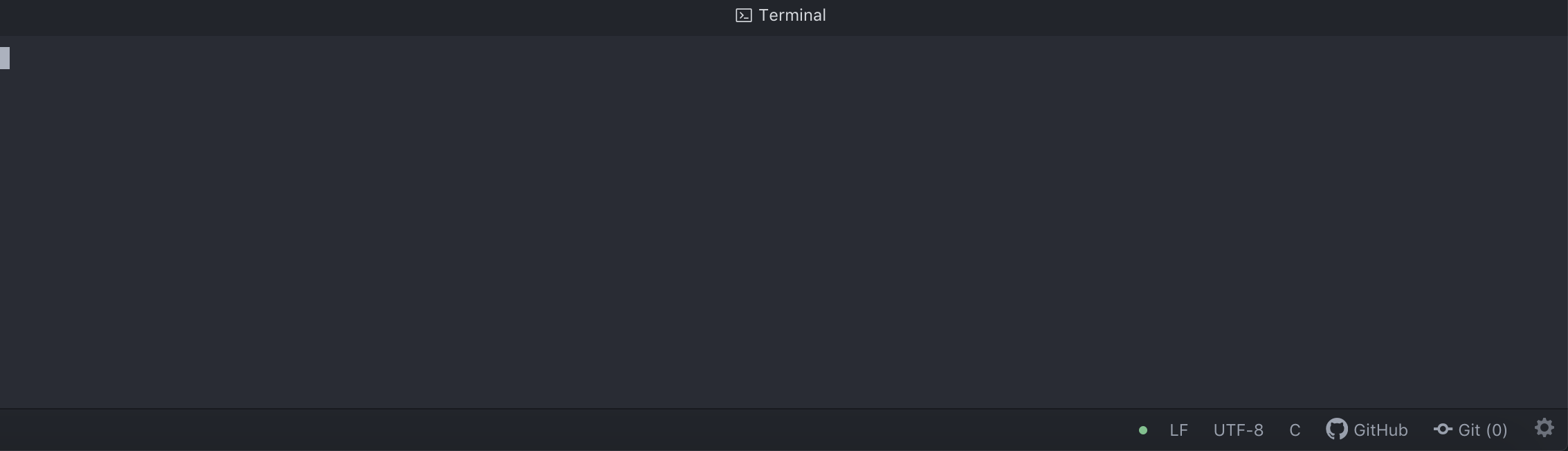

When I try to build a program which includes multiple files, the terminal pops up but shows no errors nor does it confirm a successful build. When I try to build other programs that include a single main file it is a successful build. Here are my statements that include other files as well as the pros terminal screenshot. Any advice would be greatly appreciated
#include “math.h”
#include “main.h”
#include “PID.c”
#include “Init.c”
#include “Auto.c”
30%20PM
You are probably initializing a global object that is causing a problem.
Try removing your includes until it is solved.
Try doing a clean build (Build->All).
Also, you should never include source (.c) files, you are risking violating the multiple definition rule.
You should start reading learncpp.com
