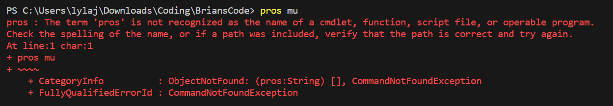

I was trying to upload code to my robot brain but I repeatedly go this error
any ideas how to fix it? (please hurry I have a scrimmage on Sunday)
If you installed pros through the vscode extension make sure you are running the command in the special “PROS terminal” in vscode and not just any normal terminal. You can select which terminal you want to use in the bottom right corner next to where the terminal is. If you can’t see this option make sure the vscode extention is installed and enabled, and you have a pros project open. If it still doen’t show up try closing and reopening vscode or reinstalling the extention.
If you didn’t install pros through the extension you can try uninstalling and reinstalling pros the same way you did it before
tyyyyyyyyyyy, it worked
