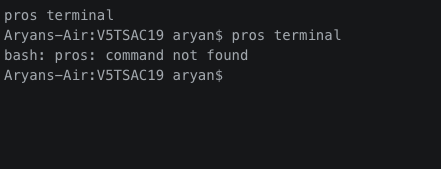

I cannot access pros terminal for debugging. I get this error13%20PM
The command has been changed from pros to prosv5 for PROS 3.
Thanks! The documentation on pro website: https://pros.cs.purdue.edu/v5/tutorials/general/debugging.html is outdated
