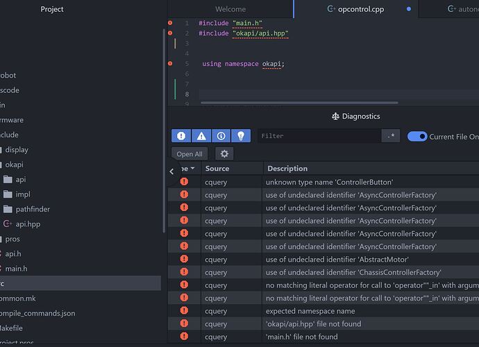

I am having trouble compiling my PROS code (first time user) due to the program not recognizing other files in the PROS project?
All packages are up to date and I have tried a clean build of the project. The syntax seems correct.
the main errors are :
expected namespace name
‘main.h’ file not found
‘okapi/api.hpp’ file not found
Any Idea to the cause of this? Thanks in advance.
https://vexforum.com/index.php/attachment/5c2925072edb0_PROSErrors.JPG In the pic it appears your main.h is in a sub-folder “pros” so you need to use
#include "pros/main.h"
also you need to include the okapi api inside the main.h file as explained here.
It doesn’t look like it’s in that subfolder. The subfolder “pros” is closed right now. Look at the arrow beside it.
It does look like there is a path issue, but I don’t know what the default is for pros so I don’t know what to shift.
Yea main.h is not in the pros folder, that looks the same as my code. It could be that “big-robot” is in a sub folder of “code” but that should be fine? Start by taking out the include for the okapi api and go into the main.h file and un-comment the include there, it should be about line 43
No luck there, I tried using big-robot as the project folder as well. After making a new project and replacing it’s opcontrol.cpp with my copy it seems to have worked. Strange, because doing a clean build should fix that.
The syntax completion tool is using the root directory to search for paths (the directory with .git, .vscode, code). I’m not sure what that directory is called, so I’ll call it foo. The tool is effectively searching for main.h inside of foo/ and inside of foo/include/. Neither contain the proper header files, so you’re going to see that “main.h file not found” error.
Try opening the PROS project more directly, such that the big-robot folder is the “root” directory. If you’re working with multiple robots, you can add multiple PROS projects and syntax completion will also work.
