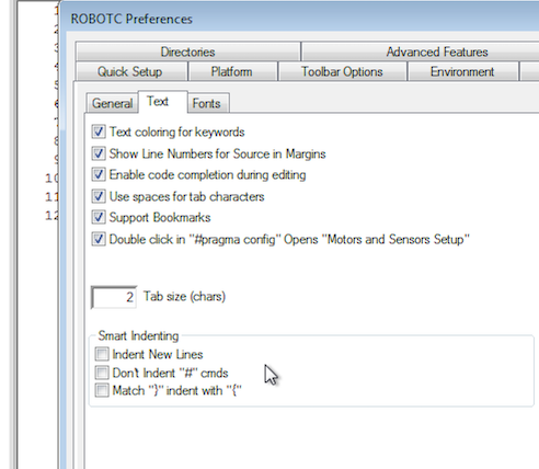

What I mean is that RobotC actively messes up my indenting. Visual Studio and other mainstream IDEs can be extensively configured to match the programmer’s style.

If you don’t like the auto indent etc. (I don’t like it either, but I also don’t like what VS Code or eclipse does) turn it off.
I understand that even what PROS provides is far from a real debugger. My point was just that, with PROS, the capability is there to emulate most features of a real debugger, while RobotC’s debugger is limited to just what is built-in (which, admittedly, is quite a bit).
The turn-it-off argument will remain, but that doesn’t change the fact that the auto-indentation in RobotC can be quite infuriating. Visual Studio (less-so VS Code) has far greater flexibility in terms of tuning the auto-spacing/indenting than just an on-off toggle.
If RobotC had a CLI and could be integrated with mainstream IDEs, I think many complaints about RobotC would no longer persist.
