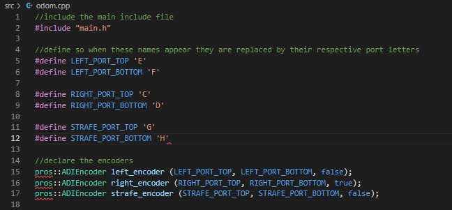

When I build my program I get an error for missing a semicolon (which I am), but VScode isn’t identifying that I’m missing it with a red squiggle.
Is this intended or is this something I can fix?

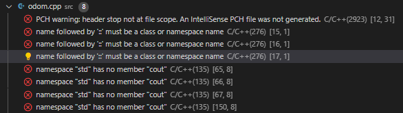

Thanks! I downloaded it, but now there’s error everywhere!
and even more errors!
It seems like it’s finding errors that don’t exist because PROS has no issue building.
Everytime I open a file it has errors, it seems that I can’t use std:: anything?
did you make sure to
#include <iostream>
to use std::cout?

It’s in my main.h file
You can ignore the stuff about cquery. if that’s too much configuration for you, install the clangd
extension instead of the Microsoft intellisense and it will work out of the box provided you use the build command I mentioned.
A popup asked if I wanted it to auto-configure and it said yes, so I already had that line in the json file
I just ran that command in the terminal and it worked!

That fixed the std:: issue ! yay, but pros:: is still giving an error
You will find the vscode clangd extension is nicer than vscode intellisense.
