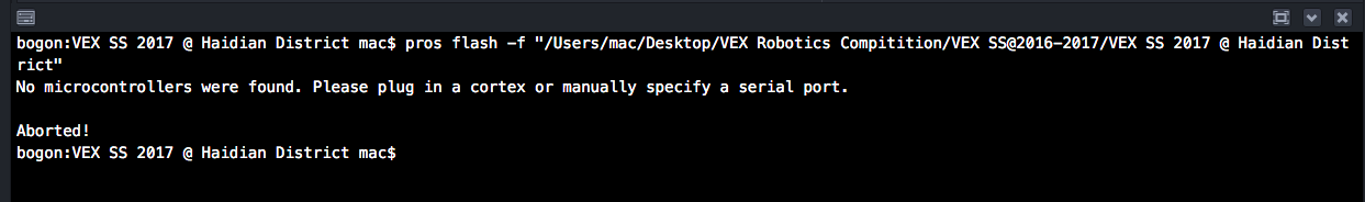

Hey, how to upload firmware to the microcontroller?
Tony, how do you have the Cortex connected to your computer? You may be able to find drivers for macOS that support USB A-A operation. Only the Programming Hardware Kit works out of the box.
