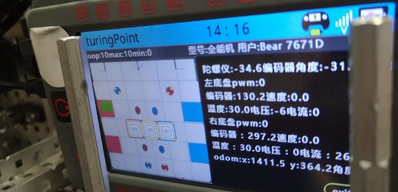

I wrote an odometer.The requirement of accuracy is very high.
prosv5 gyro value is 0-360
In my architecture, I recalculated the angle of change for each LOOP.
If the robot makes a circle, the integral value will change to a maximum of 360.
How to solve this problem?
In practice, I input 180 degrees. The robot will keep turning around.
