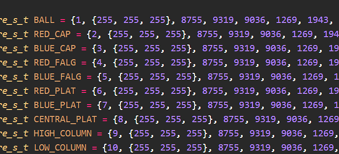

I read the document and did not elaborate on how to set up VISION.
I set the ball as the first signature, but I don’t know where to find the parameters generated by it.
How do I get the parameters in the following picture?
The parameters in the picture are input by myself.
What I did was create a C++ Pro project and it give it to you in the robot config file.
This is correct information for VCS, but PROS does things a bit differently.
The Vision Sensor saves all of the signatures that you configure in the Vision Utility Application on the Vision Sensor itself, so there is no need to set the signatures in your PROS program.
That being said, we understand that it can often be easier to configure signatures with their parameters in the code. The next set of changes on our roadmap for release will add the ability to get and set signatures programmatically like you are trying to do here.

The test is valid, but I can’t define a ball or cap and recognize him.
He seems to be identifying by default.
Where in the documentation does it say that?
I have not found anything that says the camera stores the signatures. My preliminary testing using PROS and trying to use signatures I defined on the camera doesn’t seem to point to that either.
This help article says the signatures are saved in the code. Not the camera.
https://help.vex.com/article/72-how-to-configure-the-vision-sensor-in-vcs
After a little digging I found that the vision signatures that you define in the VCS Vision utility can be seen if you unpack the .tar file that VCS generates when you save the project. That .tar file has a .JSON file in it that contains a JSON object with the signature definitions.
I was able to create a vision signature object definition and assign all the values to the fields, but I still can’t seem to get the camera to function with PROS.
