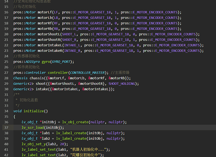

[Prosv5]The problem of setting the gyroscope to a global class
I try to play "pros ":ADIGyro gyro(GYRO_PORT);'set to global class.
Then I cannot be at "void initialize();"The gyroscope has been initialized.
Does this have any effect on the initialization of the gyroscope?
I found an abnormal gyro reading in today’s test, and I’m not sure if I set it as a global class relationship.
Configuring an ADI Port as a gyroscope starts a roughly 1300ms calibration routine in Vex OS. When you declare a gyro object globally, it will start this calibration effectively at the beginning of
initialize()
. As a result, you will receive invalid gyroscope values for the first 1300ms of the
initialize()
function.
When you call the constructor for a gyroscope at a local scope (such as in the
initialize()
function), then the 1300ms delay will occur during the call to the constructor.

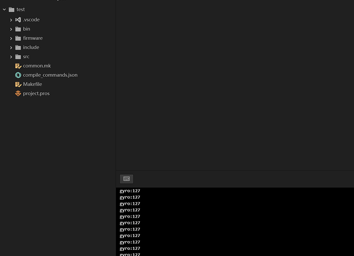

When I updated prosv5-cli to 3.1.2 okapilib to 3.3.5 .
gyro.get_value () always returns 127.
I don’t know why.
There’s a bug that was introduced in PROS kernel version 3.1.2 that causes the behavior that you reported in your github issue. We have a fix written and tested for this issue, and will be releasing it as soon as possible.
The fix is live now in PROS kernel version 3.1.3, if you run
prosv5 c u
in your PROS project’s directory then it will update and fix the gyroscope issue.
I upgraded the prosv5 kernel to 3.1.3 okapilib to 3.3.5. The problem is still there.

I re-created the pros 3.1.3 program and the questions remain.
But when I switched back to the branch of pros3.1.1, everything was fine.
I usually use static variables within a class to determine how many times the constructor executes because I think the ADIGyro class can only be constructed once.
pros 3.1.1 okapilib 3.3.4 it’s all right.
pros 3.1.3 okaplib 3.3.5 it’s looks like have some bugs.
The code is exactly the same, and I’m sure I didn’t make a mistake
@3038922 we apologize for the inconvenience. As it turns out, the 3.1.3 template was originally built incorrectly, but this has since been resolved.
To get the correct version of kernel 3.1.3, please run the following commands:
purge the old version:
prosv5 c p [email protected]
fetch the new version:
prosv5 c f [email protected]
then, to apply this to projects that may already have kernel 3.1.3 installed:
prosv5 c a --force-apply [email protected]
Problem solved. Thanks for your team’s efforts.
