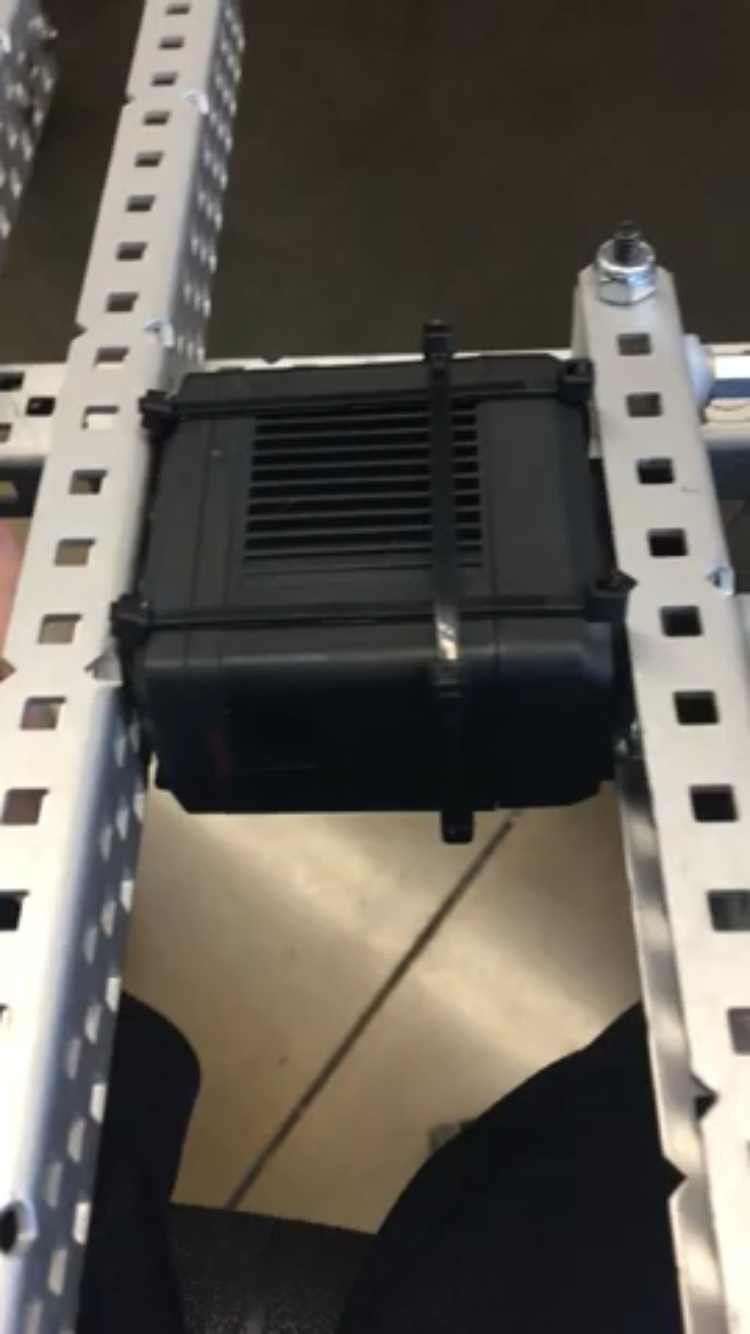

I dont know how exactly you have your zipties mounted, but I cannot think of a way in which you would not be able to slide the zipties on and off of the motor.
Between the shaft and closest mount.
Ah, well you dont have to do that.
It works well.
Im not saying doesn’t. Im just saying there is a quicker and just as effective option that doesn’t require the cutting of zipties in order to get the motor off, or the remounting of them for that matter.
Rubber bands? I did mention that.
You could create guides on the left and right with standoffs, and then have a top that is on a hinge that could easily be taken on and off.
All this being said, I die a little on the inside every time one of my students mounts a motor without using screws…
Well most of your motors should not really be overheating in the first place. There probably is a reason why. Especially with V5 motors that are stronger and better.
No, it still involves zipties, it is just in order to swap you just slide the zipties away. No cutting required. image (ignore the C-channel behind the motor)
And if this is mounted on a vibration laden system (like an intake) then you put a rubber band around it for good measure.
