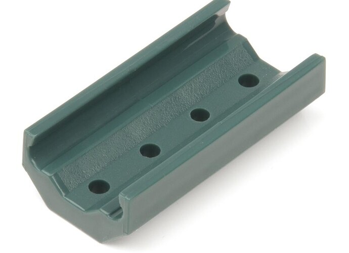

We won’t be able to use nylocks because we are using the linear slider outer trunk shown below.

We had the same problem. Move your stopping rod closer to the back of the puncher so the firing rod doesn’t have to much linear motion.
