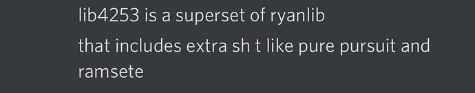

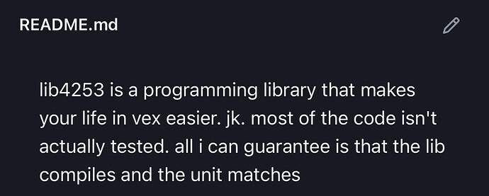

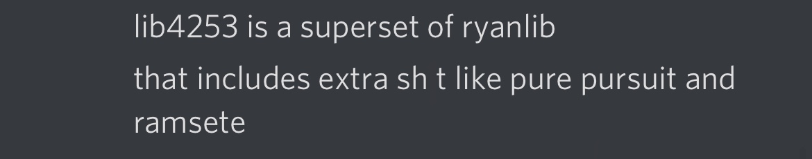

tbh i can probably test ramsete if i wish, but i certainly got better things to do
