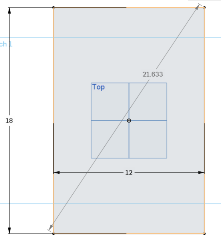

  1. SG2B Implies that size limits for robots are rough 15in by 15 in as “[22in limit] refers to the horizontal distance measured between any two points of the Robot, including
    diagonals, relative to the playing Field (i.e., it does not rotate with the Robot).” If the diagonal of sqaure bot was 22in, the sides are roughly 15.

If a square bot is in spec and they use diagonal measuring for expansion, it wouldn’t fit (Pythagorean theorem to calculate diagonal of a square).
I noticed the diagonal is wrong as well. Seems to be a typo that needs fixed.
18 x 18 already has a diagonal bigger than 22”

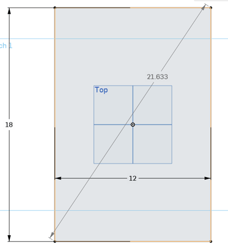

SG2B seems like it needs confirmation from the GDC ASAP since teams will very shortly (probably already started) start building chassis. If this holds, an 18 inch long robot can only be roughly 12 inches wide to meet the diagonal less than 22 inch.

honestly, try hole counting the hero bot, if the hypotenuse of that is longer than 22in then we know that the starting position rule is just an error
Unfortunately, at the moment, the bot is 12.5’’ (and some change) x 12.5’', having a hypotonus of ≈17.68.
if you want to start in any rotation. it should be easy enough to just rotate and then use that extra 3 inches on each side
ok so then in that case the diagonal rule might be intentional

The GDC has said that they are going to fix the expansion rule. I assume that’s just making the box move and rotate with the robot.
