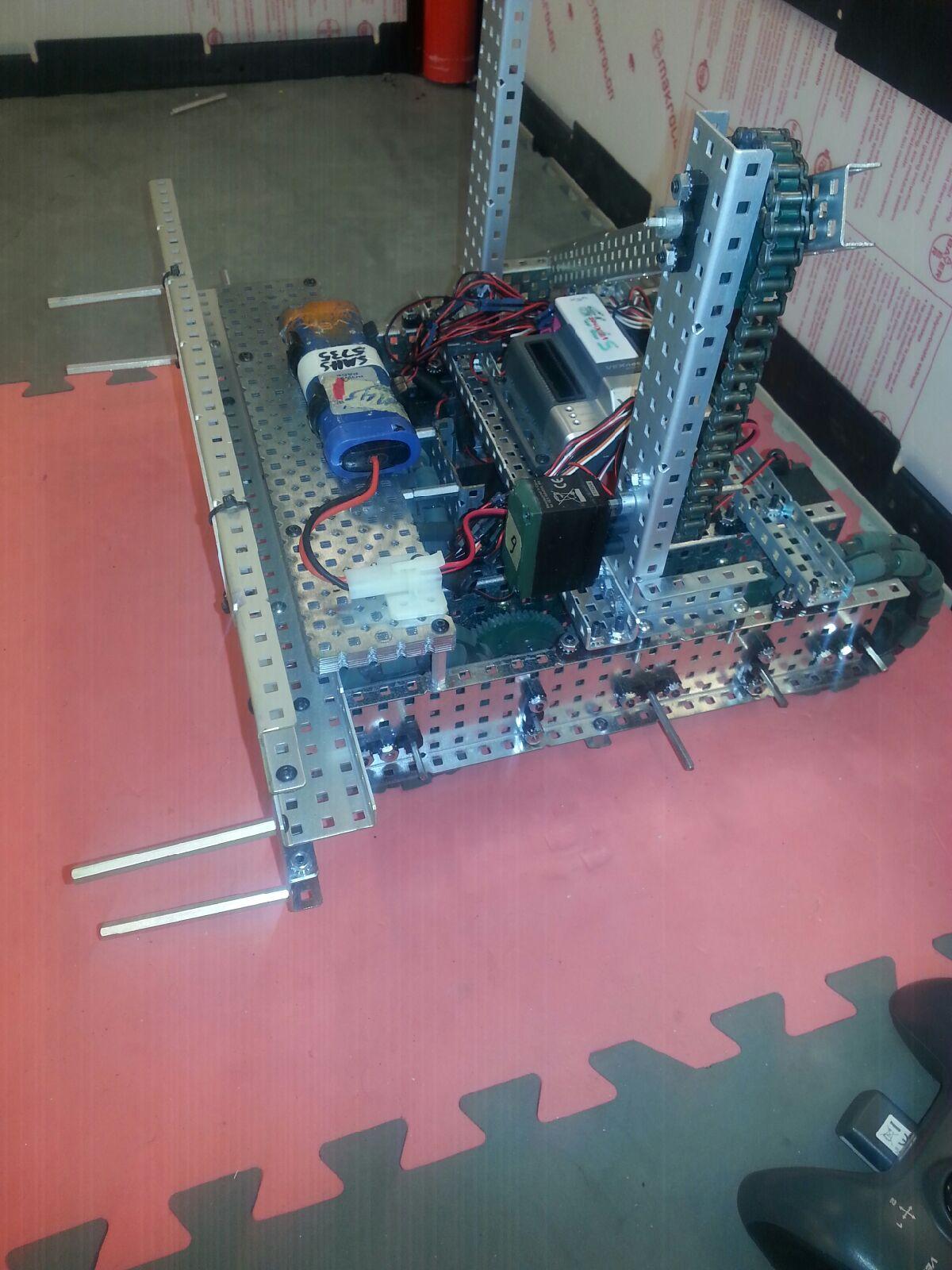

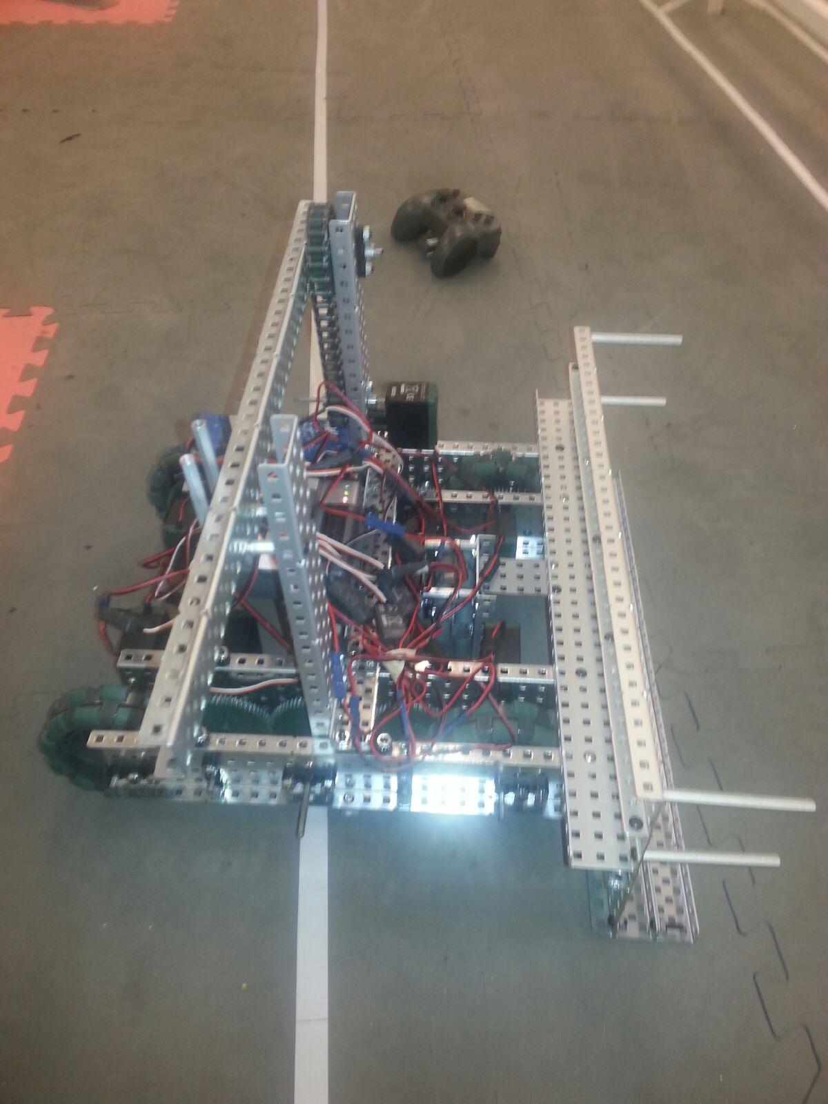

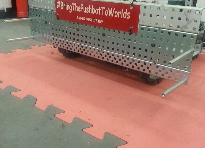

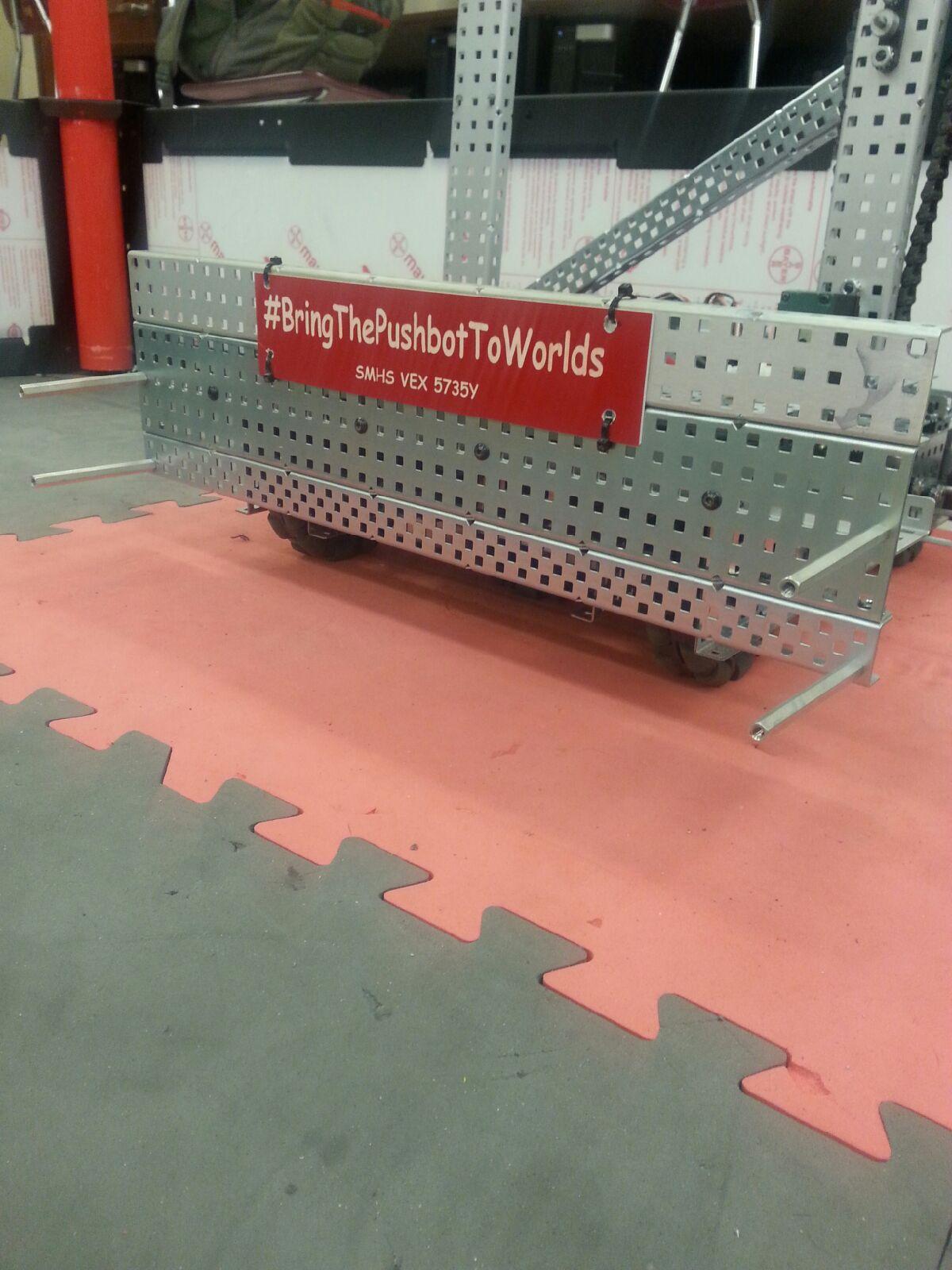

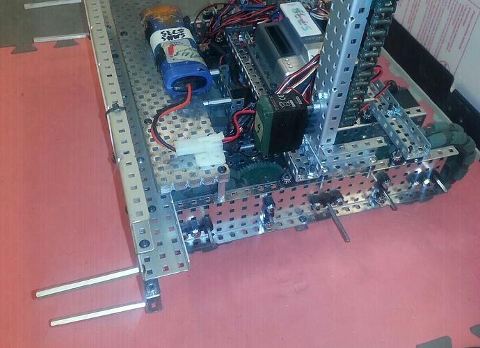

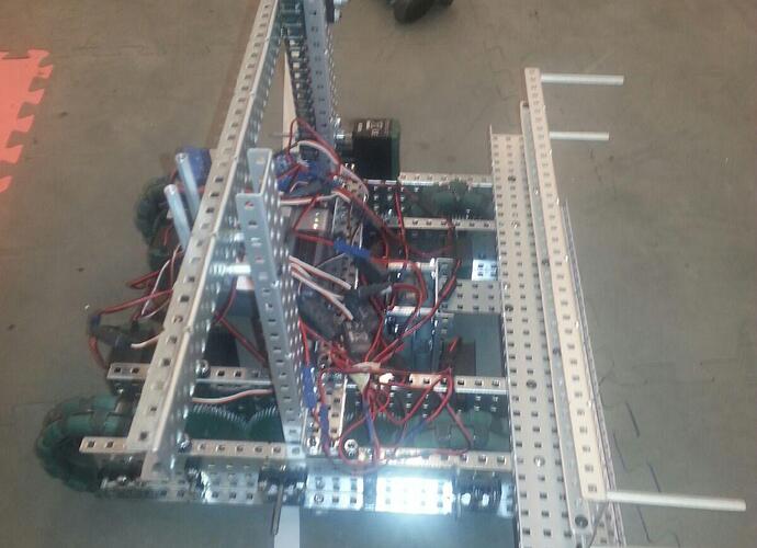

So, my team has decided to go with a pushbot, and in our opinion, it works great. The only problem that I see is sometimes stars will flip upwards and get stuck on the fence causing us to not be able to push under effectively. Now, I can simply back up and let the star fall so that I can push again, but I was wondering if anyone has any ideas on how to prevent the stars from getting stuck in the first place. Is there a way to build around it, or is this something where I just have to rely on good driving?
Do you have pictures of your bot?
Here are a couple of pictures. The front plate that we use to push was lower, but we decided to take some off of the bottom. We have weight in the front of the robot, right behind the front plate. Any ideas are appricieated. Thank you
Unfortunately, thats the one issue with pushbots. I can attest from experience that if you have the star oriented the wrong way, it wont go under. The stars are quite strange like that, and the only way to get around that is to move it so that it goes under. Try orienting the star so that 3 points are on the ground, that usually gets under the fence with no hassle.
@artsy.andrew We try to do that and it works fairly well. Usually, if we attempt to push 4 or more stars at a time, we will get at least one star stuck. Once we raised the front plate and moved our weight to the front, it happens at little less, but I dont have to much room to raise the front. Thank you.
From what I have seen, the most successful at getting stars under the fence have a pushing surface that will just barely fit under the fence. I would think that if the pushing surface was tilted with the top slightly more forward than the bottom, that would also help.
In your first picture, there was a lip like structure on the bottom. I wonder if it would work to have that on top to help push the tops of the stars forward.
If you try that, let me know how it works.
We had attempted having a lip structure on the top as well, but we had trouble with stars getting stuck to the lip, and it hadn’t made a big enough difference to keep on there. We had just taken the bot to a competition on the 14th. It worked well and we did well, but I definitely will attempt your idea with the angled plate. Thank you for the suggestion.
