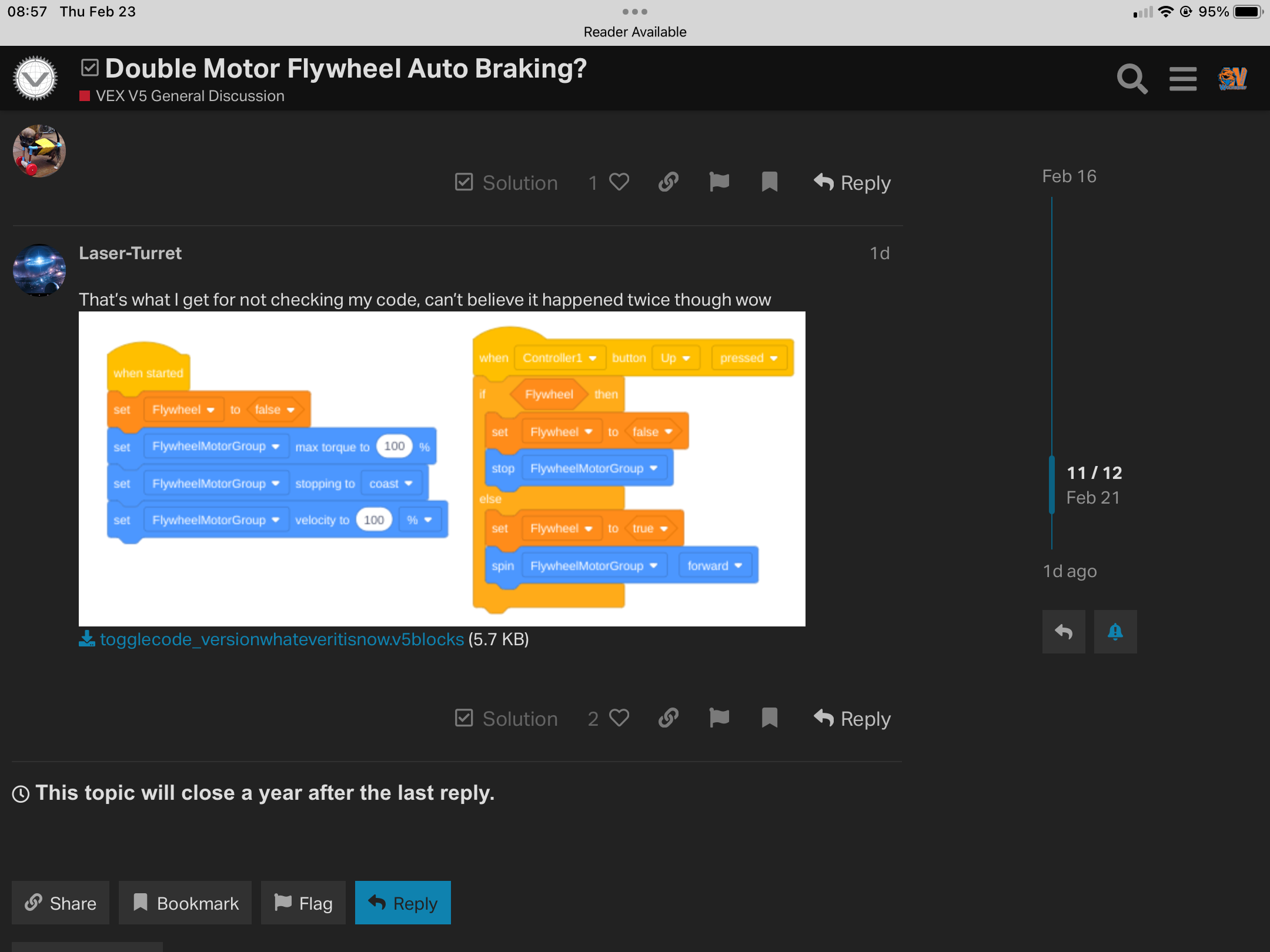

Hey so my team is using block code to code everything on our robot. We noticed that when we used code like the picture attached to create a toggle for our flywheel, the toggle will only work if we run a “vex code project 1” instead of just hitting drive. Anyway to fix this?
The “drive” button on the brain is just the default controls for the the claw bot and hero bot, and there is no way to make it run your program. You have to select the program slot to run your custom code.
Ok thanks so much!
