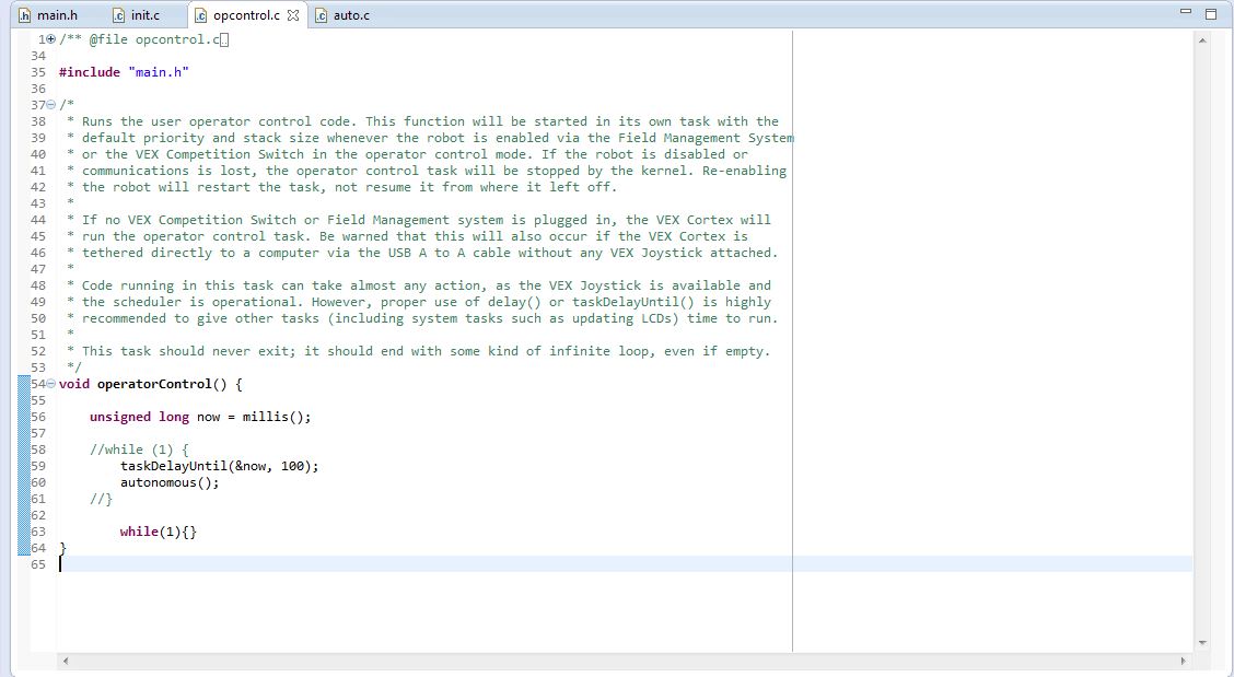

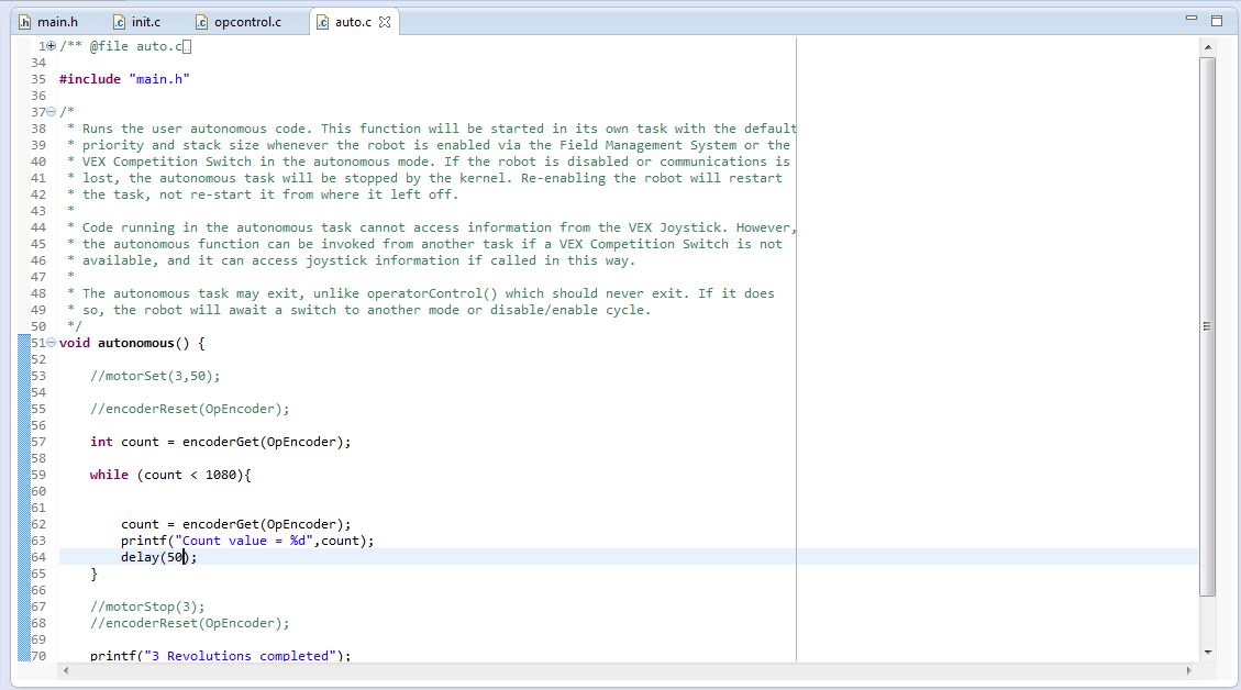

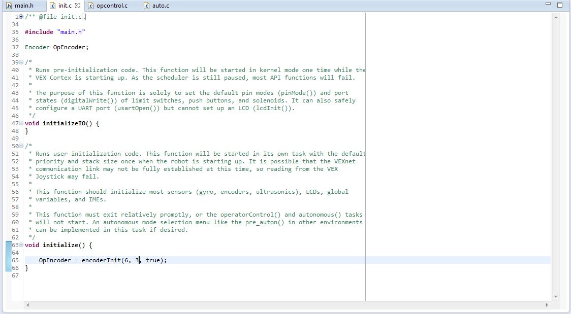

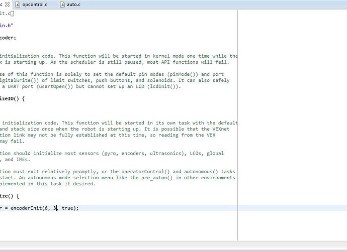

I’m using PROS IDE to write a program that would return the value from a quadrature encoder (to test if the encoder is working). In order to test, I just manually rotate the central portion of the encoder that fits into a shaft. However, the value returned is always 2. I tried changing the ports and also reversing the ports. On reversing the ports, I get the value -2 but the value never changes even though the encoder wheel is rotating. Here are snapshots of the code. Is there something wrong in what I’m doing?
Thanks.
Nush - I do not see any errors in your code. With that, it sounds like you have a bad quadrature encoder. Have tried testing this with a different encoder?
Thanks for the reply. Yes, I tried with the two encoders that are part of the 2-pack sensor, provided by Vex ( http://www.vexrobotics.com/276-2156.html). With both, I was getting the same result.

I was able to get my encoders working properly. The issue was my batteries were drastically low during testing. To my surprise, fresh batteries did the trick. I did not know that these sensors were so reliant on battery power.
So the digital pins require a minimum voltage to be read as high. It is probably something similar to arduino mega which is 3.3V out of 5V.
