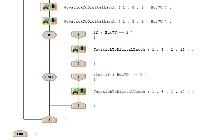

So I have programmed our pneumatics with the help of the sample program. However I have noticed that with this program, when you activate the pneumatics, you have to hold the button in until you want to close them again. I was wondering if there is a possibility of you pressing the button, then taking your finger off of it and then press it again to close them again?

I am using easy C :smiley:
Could you post the code in easyC?
Thanks
In EasyC v4, you’ll want to use the Joystick to Digital Latch block, which will get the same functionality as what I posted. Use it just like any other Joystick function.
OK, and I would I use this instead of the digital output button?
Yes. You’ll just need to use Joystick to Digital Latch. You will not need to use Joystick to Digital or Digital Output in this case.
The code still isn’t working…
EasyC implements the functionality behind JoystickToDigitalLatch of the example code I original posted, so you won’t need any of what I originally wrote.
while(1)
	JoystickToDigitalLatch(1,8,1,12);
You won’t need any of the other JoystickToDigitalLatch functions or if/elseif structure that you have.
If you’re still having issues, I can pull up EasyC when I get home tonight and give you a screenshot.
I think I kind of understand, however if you could show me on easyC when you get home, that would be great !
https://6k5fxq.bn1302.livefilestore.com/y2puxDPWfdLJwAiVMYwDmbwPhbjOMqYlZPNOlee-VhdswPACj5R68jJPPwvQfEGQqaxVGMYzVMlAYM3VeM-i3EexN_z3kbiDNYrQpTUAfnoNYo/VoltRobotics-DigitalLatch.png
Hope this helps!
