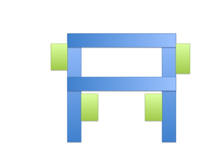

question about mecanum wheels
I was wondering if it was possible to mount the mecanum wheels like they are pictured in this diagram. The blue parts are frame elements and the green boxes are the mecanum wheels.
so my questions are:
Will this work?
Will it cause any extra stress on the motors?
thanks in advance!

[ATTACH]7340[/ATTACH]

yes .
It should work but you should be extra careful about weight distribution and turning. Since the front and back wheels are a different distance apart, they have different radii of turning. AKA the back wheels will travel further than the front wheels will in the same amount of time, straining the back wheels’ motors harder.
Thanks for the confirmation. Just thinking about my design for next year…
Yes it should be possible to make this work, but there are a couple of things you should consider:
Depending on how the robot is set up (where the centre of mass is, and the exact spacing of the wheels), the more closely spaced pair of wheels may turn more slowly when the robot rotates than the more widely spaced wheels. If that happens then the more closely spaced wheels will be carrying more of the load. The closely spaced wheels may even end up forcing the widely spaced ones to turn faster than their free speed (i.e. the closely spaced wheels might backdrive the widely spaced ones). This is a situation you want to avoid. Putting the weight towards the wide end of the robot should help prevent these problems.
The robot will probably travel in an arc while strafing, at least while it accelerates. This would happen if the wheels exert different torques on the robot as a result of being different distances from the centre of mass. Again, moving the weight towards the wide end ought to help.
Forward and backwards movement will be the same as with an ordinary mecanum drive.
Motors produce more torque and draw more current when they are turning slowly than when they are turning quickly. This means it is the wheels that move less far that you need to worry about.
thanks. Thats what i thought but wanted to make sure that i was thinking correctly

I meant for a constant voltage. Reducing the power value reduces the voltage across the motor which reduces both the maximum torque and the maximum speed.
For a constant voltage though, torque decreases as speed increases. So yes, if you force a motor to move slowly (including by putting a high load on it, like making it move a heavy robot or lift a heavy arm) it will exert more torque and draw more current than it would if it were unloaded.
