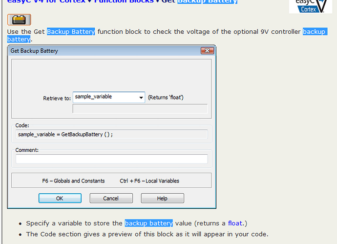

In easyC you can do this:
int uartNum = 1; // depends on where you plugged in the LCD; either 1 or 2
int rowNum;  // the number of the row you want to update; either 1 or 2
// declare a variable to hold the backup battery voltage
float backupBattVoltage;
// later, when you want to get the voltage in the code
backupBattVoltage = GetBackupBattery();
rowNum=1;
setLCDText(uartNum, rowNum, "9V battery: %f",backupBattVoltage);
// don't have to use variables for uart and row; could have:
// setLCDText(1, 1, "9V battery: %f",backupBattVoltage);

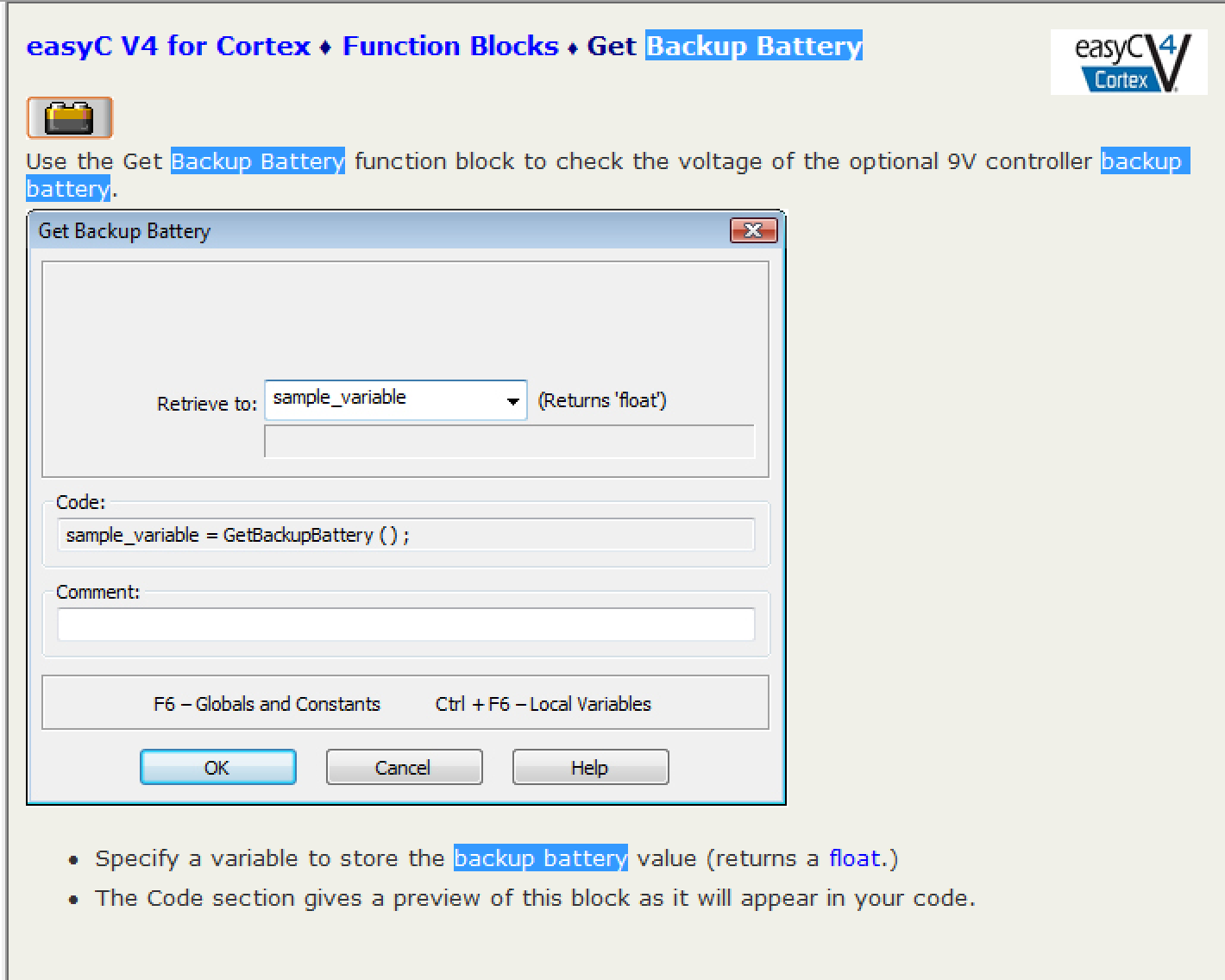

Here’s a screenshot of the help screen for GetBackupBattery:
