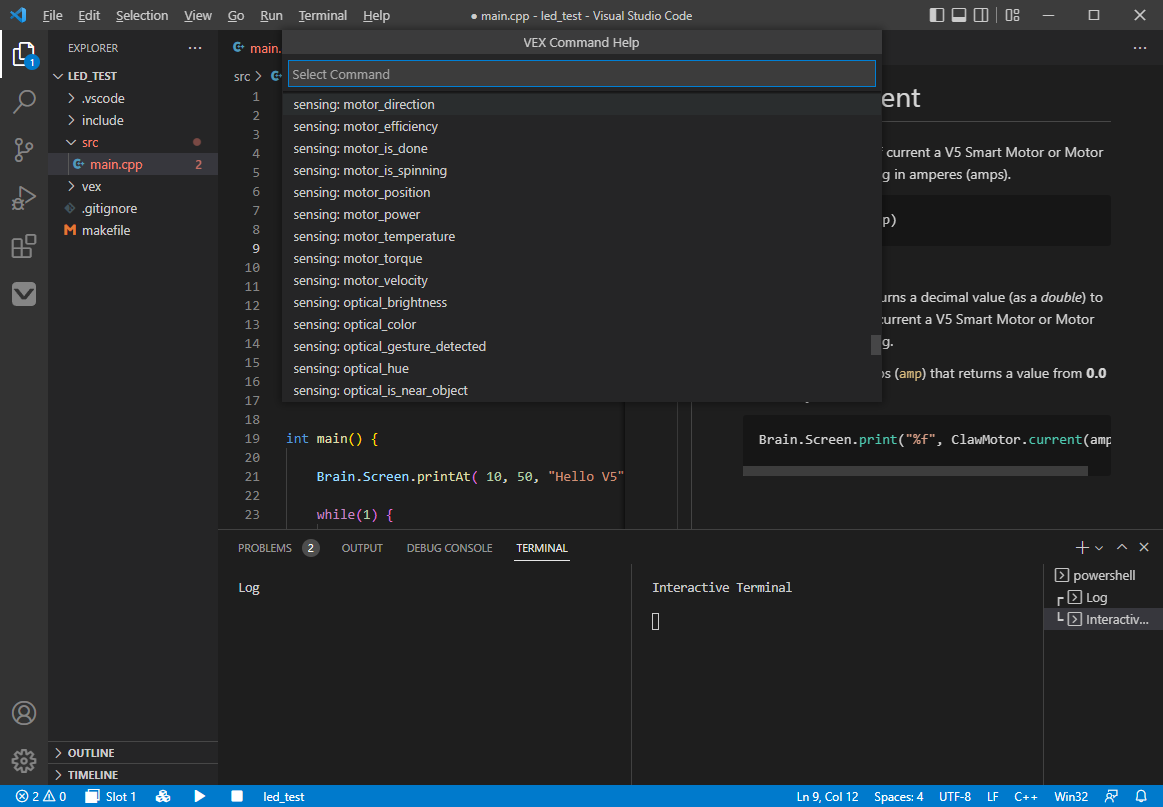

Also, confused about API. The old resource we use at VEX Help mentions motor voltage as a method:

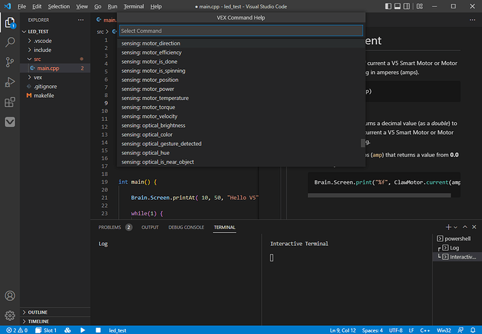

But the VEX Command Help built into the VS Code VEX Extension excludes voltage instead lists only the following:
There’s efficiency, power, temperature, torque, velocity but no voltage. Also we see a tendency to express everything in percentage now, but not very clear what that percentage represents/shows. Unless the help system is simply not finished in which case apologies for jumping the gun. So, is there another official resource where we can find proper syntax for all the vex. functions to be used in C++ / Python? I know the Library is replacing the old stuff but can’t seem to find this.
Sorry for long post, question was what exactly sensors are on that board inside a V5 motor and what does the end user have access to in C++ and/or Python via VEX Extension? Thanks.

That’s just because for rev 0.1 of the extension we pulled help from VEXcode, not everything had a help page. The best place to find the implemented API is always to look in the vex header files or use intelisense. The SDK used by the VSCode extension is the same as available in VEXcode.
